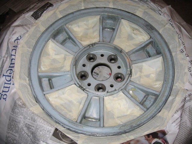

Sanded and taped off
I first sanded the parts i wanted to paint, then put one layer of zinc spray on. For the silver part I just used a spray can. Just silver wheel spray that you get in every do it yourself store. I believe I just used cheap Motip. Any brand is fine...
Then I just covered it in a couple of layers of clear gloss from a spray can.
The dark grey part I did not paint. I taped it over with news paper when spraying the silver part.
I put gloss on the whole wheel to make it shine.
