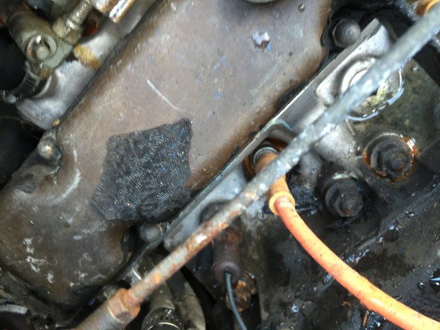

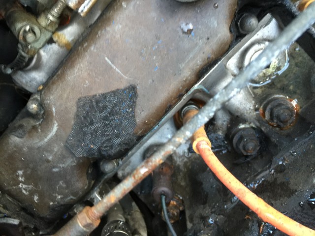

As promised, please see the valve covers on my 2.0 l. It was identical on my Fathers Dino. You can also see the brownish colour underneath. You can even see the white magnesium oxyde powder appearing!

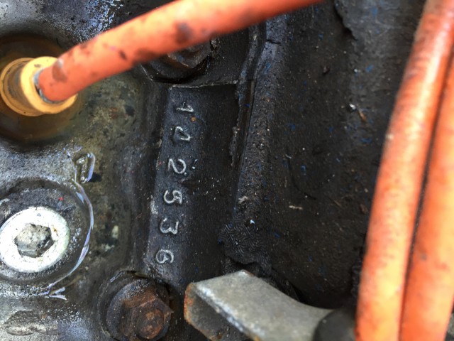

The engine number
The engine number
Flakes and the brownish colour underneath

Interesting pictures, but the picture labeled "engine number" is actually showing the engine´s ignition firing order: 1-4-2-5-3-6 !
Your engine´s serial number (135 B. 000 xxxx) is found at the right front area of the engine block, below the distributor, close to
the oil filter.
Re the valve cover finish, my experience from different Fiat Dinos is, the magnesium covers were made in the grey-ish finish as
they - probably because of the engine heat - tend to become very oxidized and ugly, if used in " bare metal". The aluminium
covers seem to have been used without any treatment, at all.
