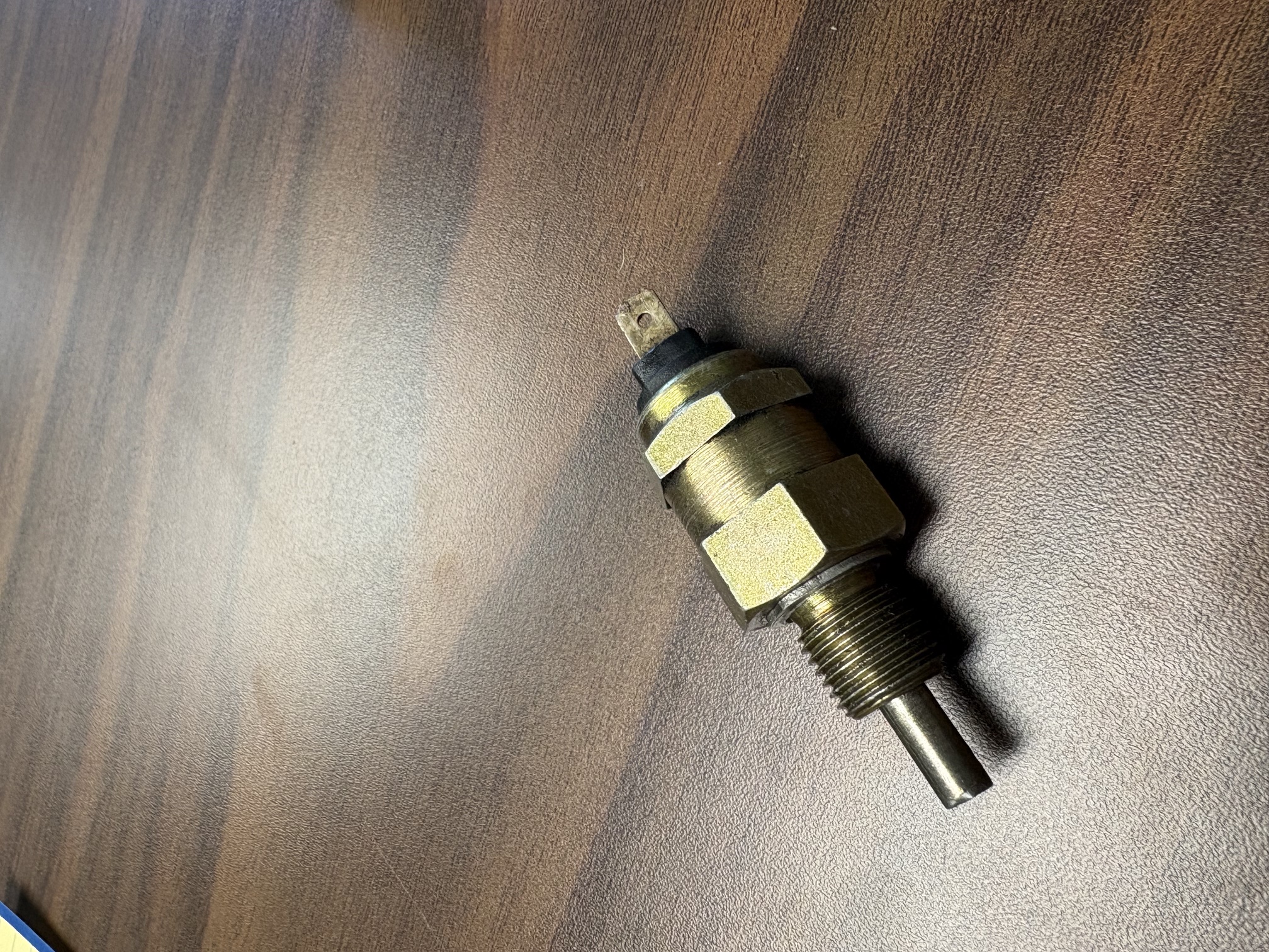

All,
My '67 Dino Spider is having some work done at GTM & Sons in Greer South Carolina and it was noted that my reverse lights are not turning on when the car is put into reverse. They isolated the problem to the swtich below which i believe is housed in/near the transmission case. We are having a hard time finding a replacement, does anyone have a source or part that we can use to replace this? Very much appreciate the help.

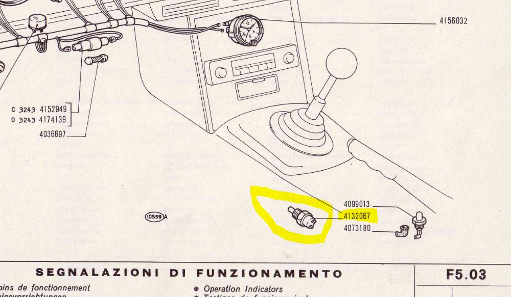

Fiat OEM number is 4132067...
search on google for "4132067 fiat"..
there will be different offers on ebay, dinoparts, arnold-classics, holtmann-niedergerke....
https://www.dinoparts.com/Rueckfahrlich ... -2-0/35715
https://shop.arnold-classic.com/9499/ru ... -dino-2000
https://www.fiatparts.de/Schalter-Rueck ... ezial/Dino
US: https://autoricambi.us/reverse-light-sw ... rrencyId=1
Posts: 275
Re: Reverse light switch - looking for replacement part
I bought mine from eBay US about 2 uts ago, it’s the same switch for the 124.225,131,134about $10 plus shipping
