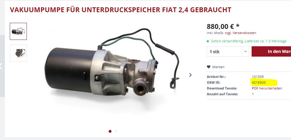

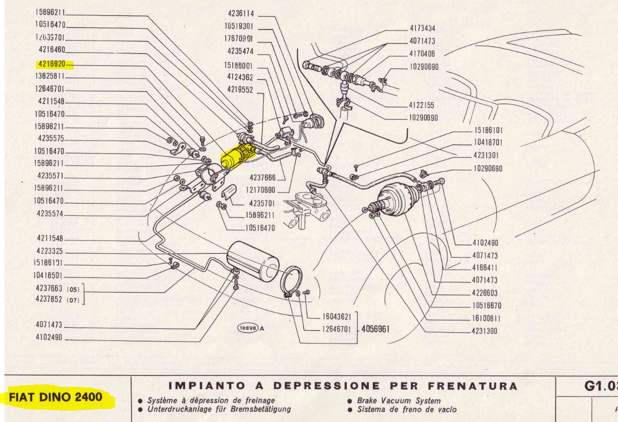

It's not about the brake booster, but about the vacuum pump for the brake booster.
That's a part that doesn't exist in the Fiat Dino Spider 2000, like the one you have.
Of course, the braking system works without an "additional" vacuum pump; it works in the other Dino models, too.
But if Fiat installed the part back then, they must have known why they did it, and it must have served a purpose.
So I would definitely repair or replace it.
