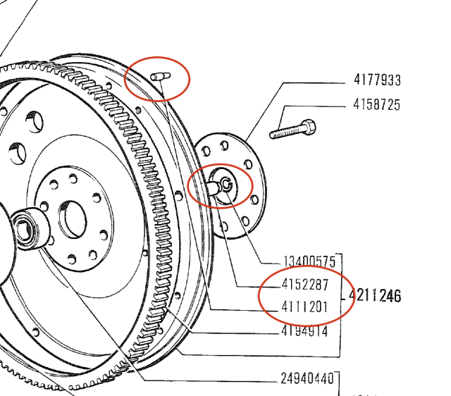

There are two sizes of dowel-pin fitted to the flywheel
a) 3 x 10.8mm diameter, 25mm long
b) 3 x tapered, about 8mm max diameter and shorter
when assembled with the clutch
the a) pins go through large holes drilled into bosses in the old pressure plate - but there are no such holes in the new plate
the b) pins are a tight fit in the old pressure plate which has 3 x 8mm holes. The new plate has holes for these but 10mm diameter, so they provide no location help.
To use this new plate, I'd have to remove the a) pins, and the b) pins are no help - so the only location is provided by the pressure plate bolts - seems like that's a much weaker solution than OEM. It might work but I don't like buying new parts for an inferior solution. Fiat did it for a reason.
flywheel sketch.png (182.1 KiB) Viewed 61240 times
Has anybody fitted one of these new clutch plates and have any comment on how well it works? Any other thoughts?

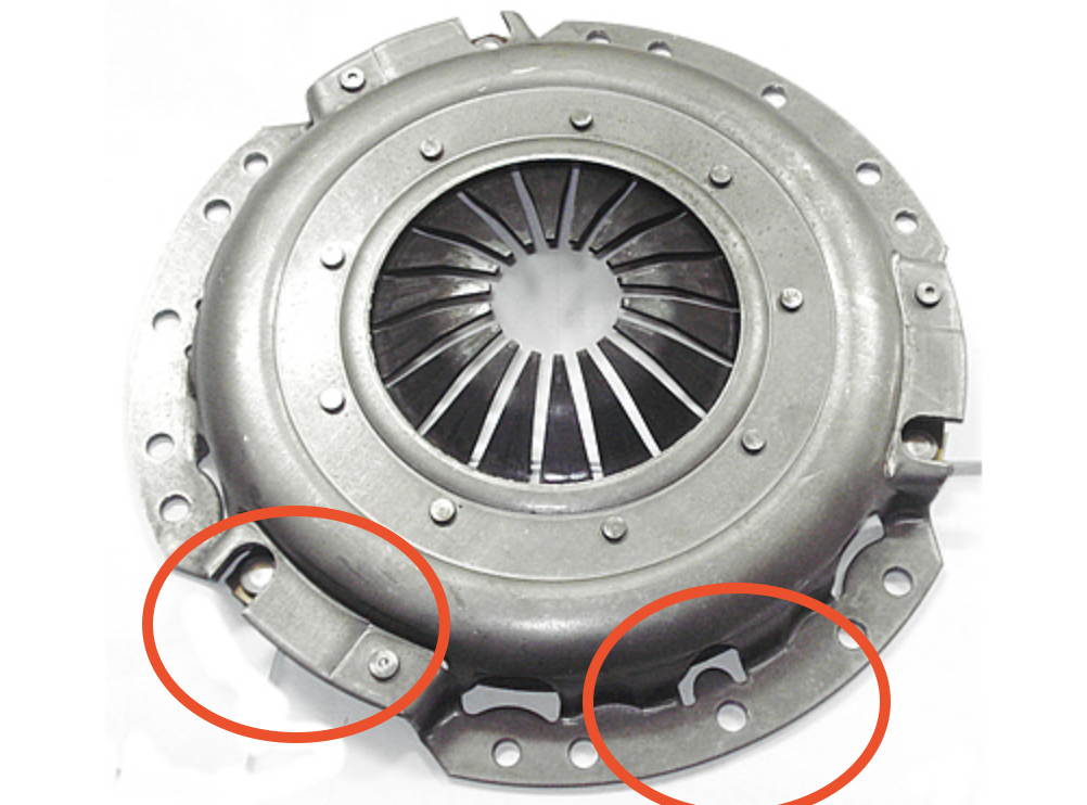

Couple of pictures to illustrate
This is the flywheel I just received new from SF
Ringed in the picture above are
a) the lack of hole for the large flywheel pins and
b) oversized holes for the smaller flywheel pins.
Then this is a picture of the "Original Style Pressure Plate 2000" from Superformance. This resembles the OEM 2400 clutch plate I have removed
Ringed in this one are
c) the smaller size hole for the small pins
d) the large holes in bosses for the large flywheel pins.

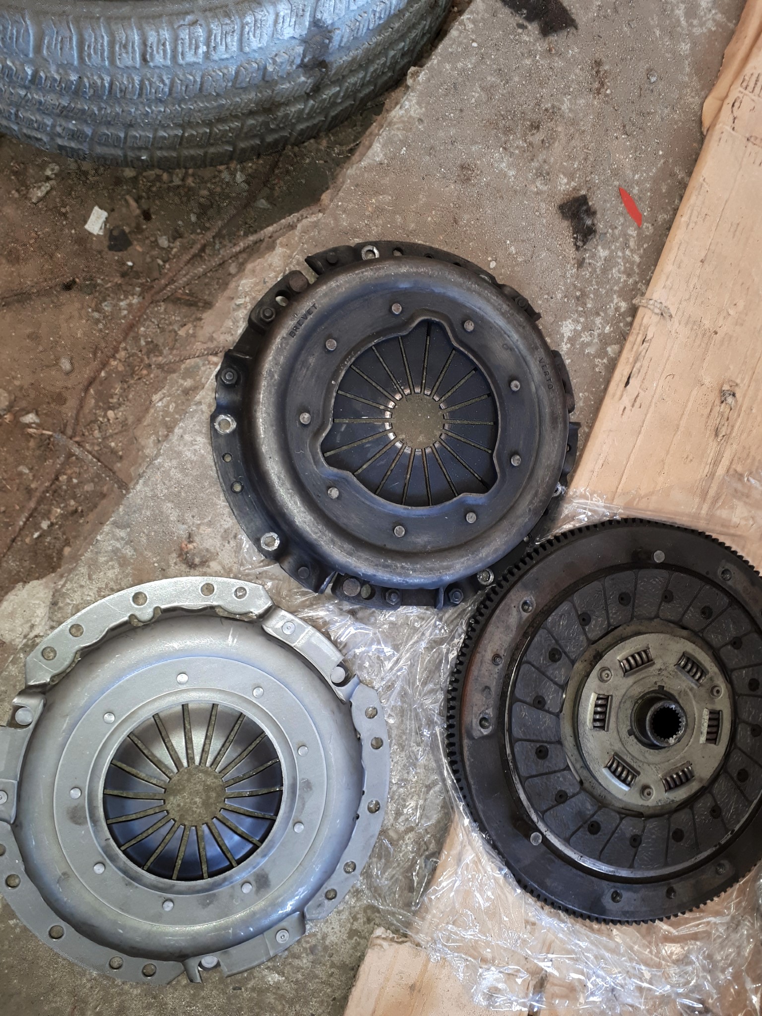

I had similar problem, the one from Superformance just did not fit. Had two clutch cables broken. What we did was to refurbish the pressure-plate with teflon coating. It was done in Hungary, but you need your original plate for that.
Re: Clutch pressure plate
Posted: Tue Oct 25, 2022 11:00 pm
by Benz 116 w
Posted: Tue Oct 25, 2022 11:59 pm
by doublegarage
Thanks, good pictures.
Shows how the new plate is completely different to the old one.
