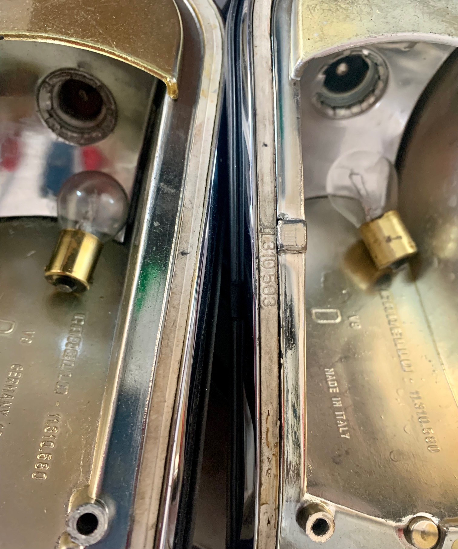

Re: 2.01967 Spider #665
How ist it in spiders: I know from the Dino Coupes, that there are German versions, where the indicator has only one contact, and yellow lenses, and the parking light is kn the main light. How is it on the Spiders? Does your German indicator has also only one contact? On my Spider I have the indicator with two contacts, and bulbs with two contacts. Maybe it’s similar on Coupe and Spider?
Thomas
Attached is a pic of both NOS lights, they have the same part number, but the orange lens one has Germany stamped in the casting.
Both are single conductor.
