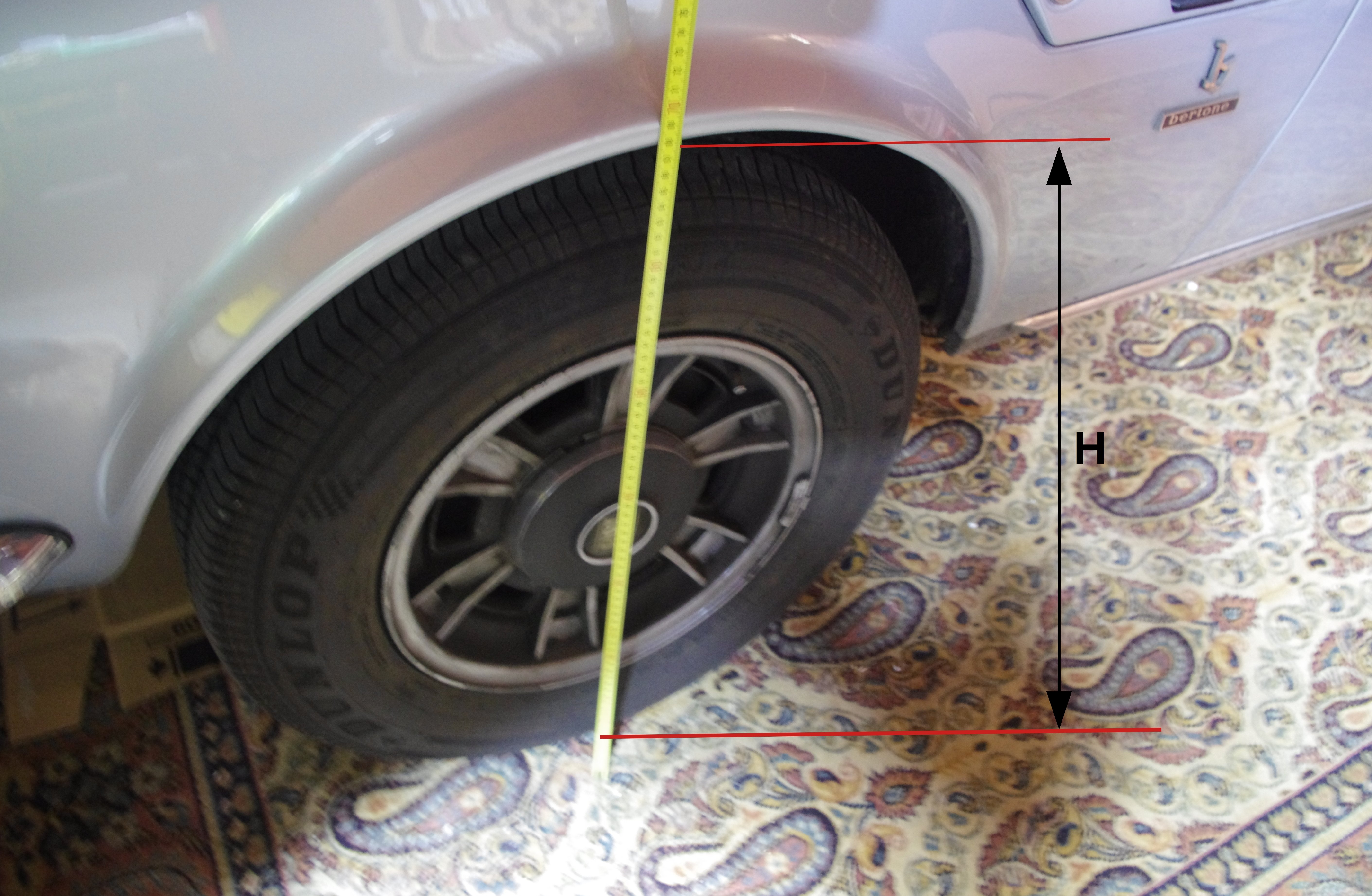

In the Front, my Dino coupe 2400 has a height difference of 2,5 cm between the right and the left body
and at the Rear, my Dino seems to have a trunk fully loaded,
So, my questions:
- which body height have you on your coupe 2400, in the front and in the rear?
- Should I replace the 4 suspensions spring (I think it could be normal on a 50 year old car)?
- Have someone bought the springs from Dinoparts? If yes, what is your experience with them?

I knew I had seen a simpler explanation/ picture, and found this picture in the F.I.A. homologation No.1640 ;)

I took the measure:
- at the rear, I have 175mm instead of 195mm
- in the front, I have 223mm at the passenger side and 228mm at the conductor side
With the rear distance, I have an explanation why my Dino seems to have a trunk fully loaded !
In the front, it's curious, because , with a distance of 223mm, the passenger side seems to be right in height or I didn't took the measure correctly.
Last summer, I asked Dinoparts what height has the springs that they sell; they have 420mm in front and 350mm in rear
I will dismantle the 4 springs, measure them and after I compare with Dinoparts springs.

It's done, I have replaced the 4 suspension springs with the rubber parts and ..... I have another car !! :D , more stable and straight
The old springs doesn't have the same hardness anymore and the old front springs doesn't have the same height !
So, don't hesitate to verify your suspension springs ......
