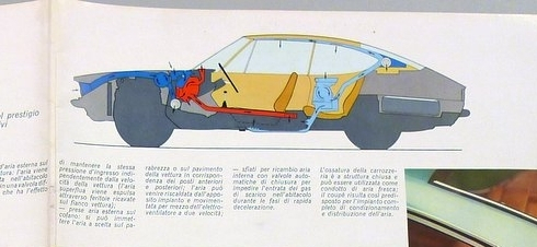

Thanks Vravolta. My understanding for the round vents next to parcel shelf is like yours, however there is much more to all this. Those round vents have a channel in the bodywork going forward which finishes in a circular lip approximately 2 inch wide which I assume by looking at the diagram would then have a hose connecting it to some kind of mechanisms behind the vent near the rear arm rests. However my theory is that fiat did not install such a mechanism possibly as it did not work, and as on my car at least they sealed off the whole area behind the armrest panel with a plastic membrane so those armrest vents are now non functional.

I have had a better look behind the armrest grill and my theory was wrong. The plastic membrane (which was damaged and incomplete on mine) seems as if it should seal off the whole area except the circular opening refered to above so that these armrest grills are open to the rear round grill and body grills. But this would mean that any incoming exhaust fumes via the side window grill could not be stopped from passing the armrest grills.
