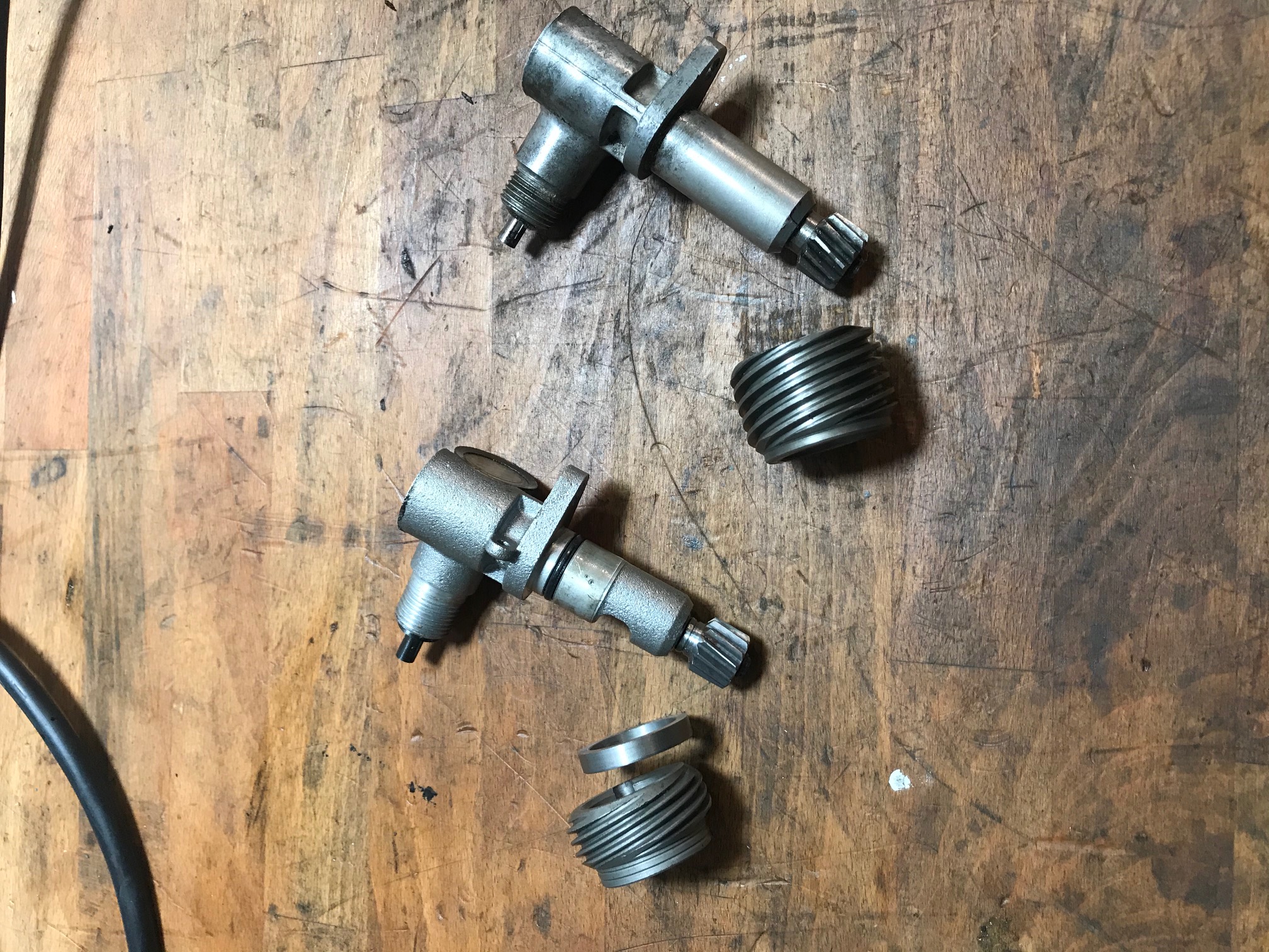

Dears
For those of you doing this modification, I just want to let you know that there is a speedo gear that give the correct reading. Well the reading will be 2,3% less then stock - to me this is enough, who cares if it is 100km/h or 97,7km/h. The stock speedo will most likely show too much anyway.
If anybody should be interested in this modification send me a PM and I will let you know the details and what parts to buy. You also need to machine a spacer due to the shorter gear. Its is no problem with the shorter gear as the drive does not ride that part of the gear anyway.
