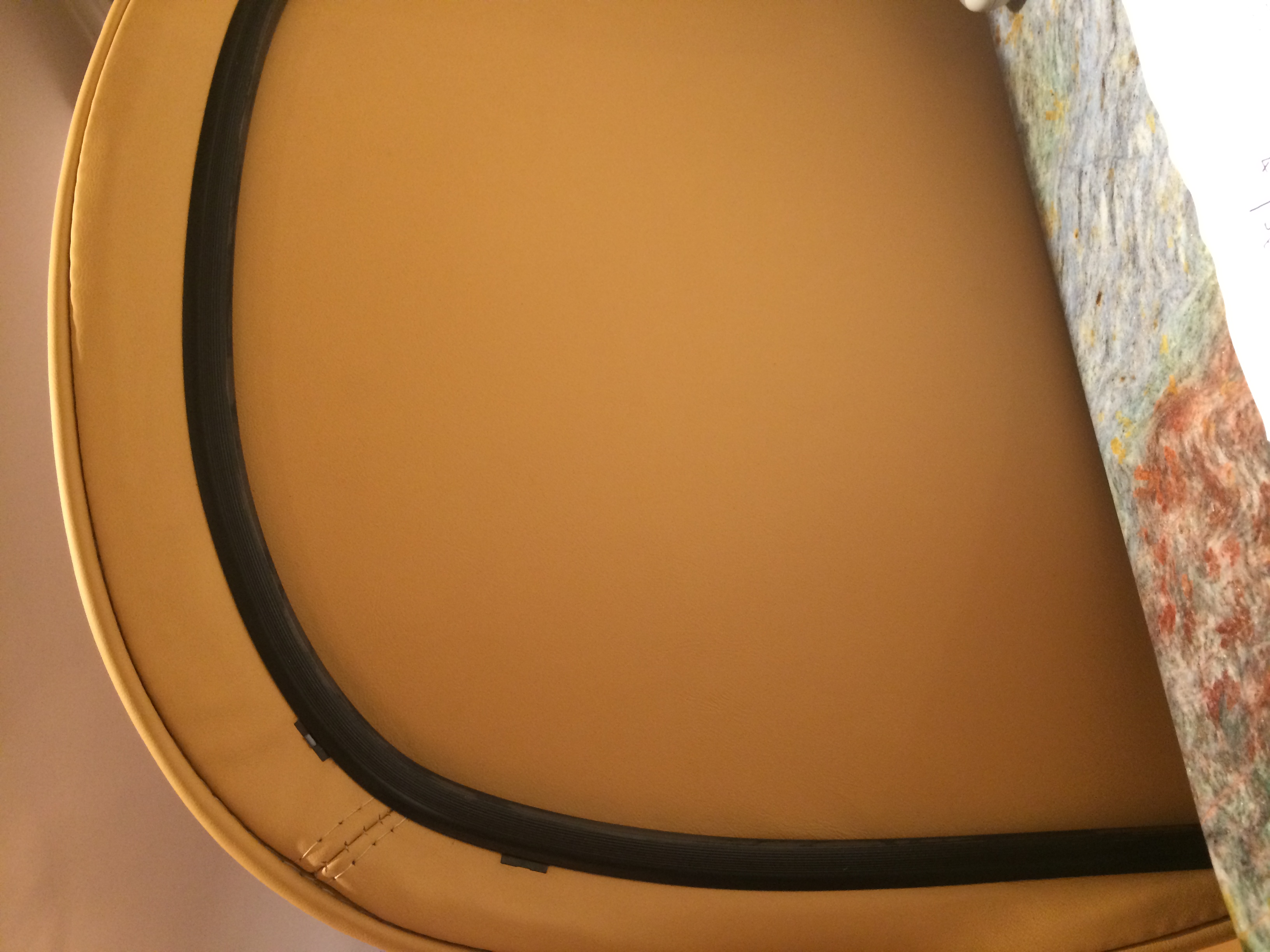

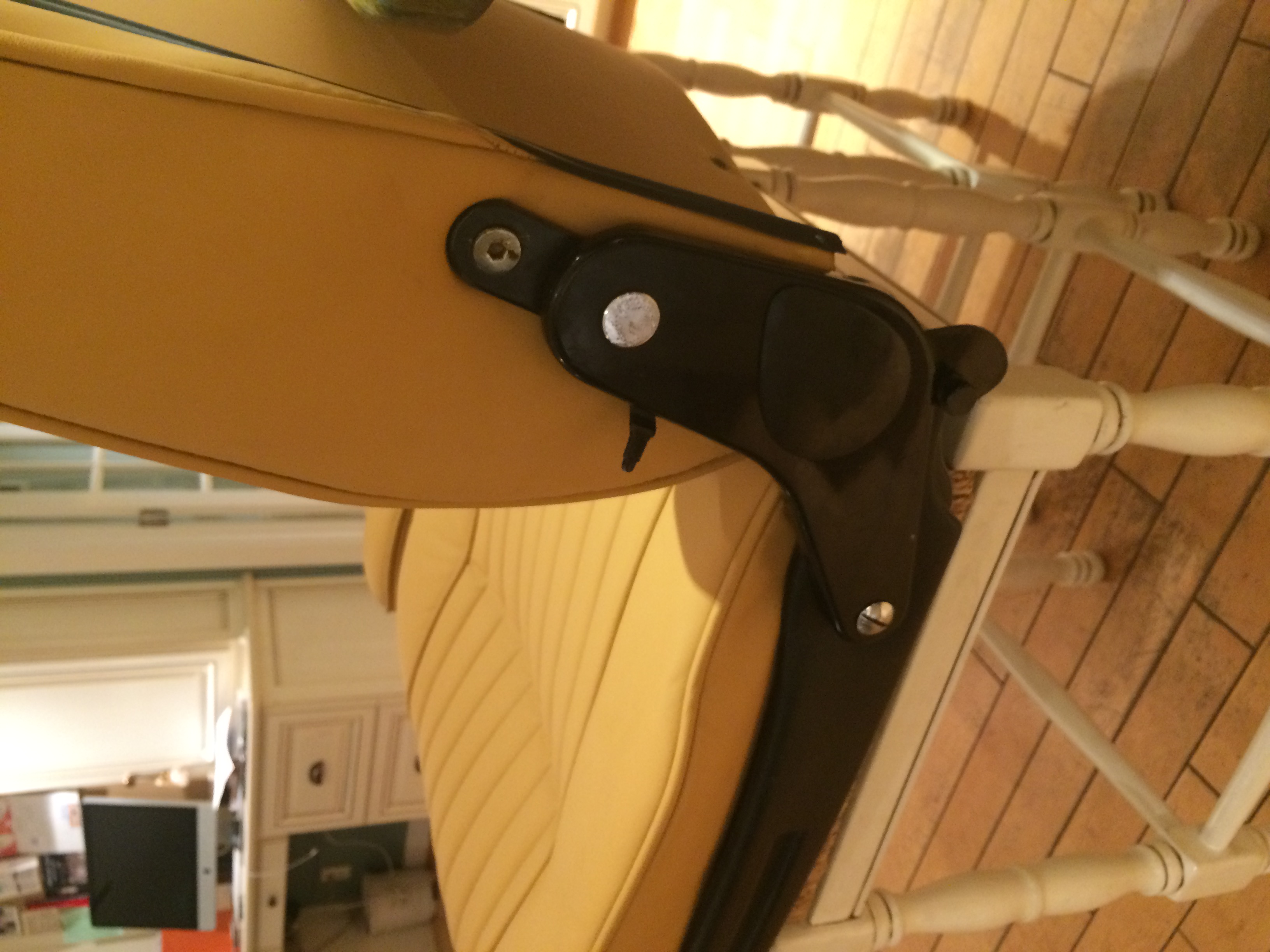

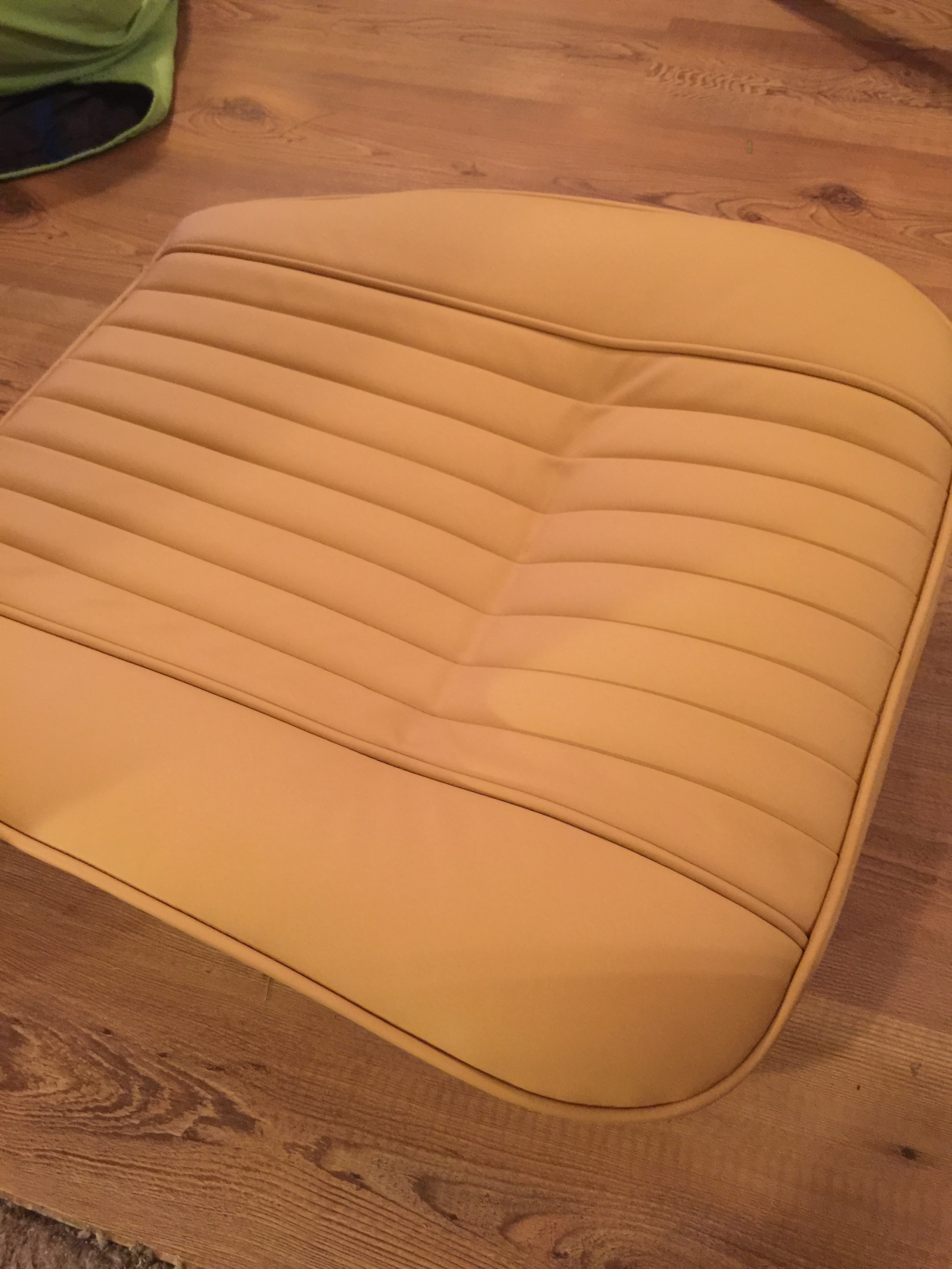

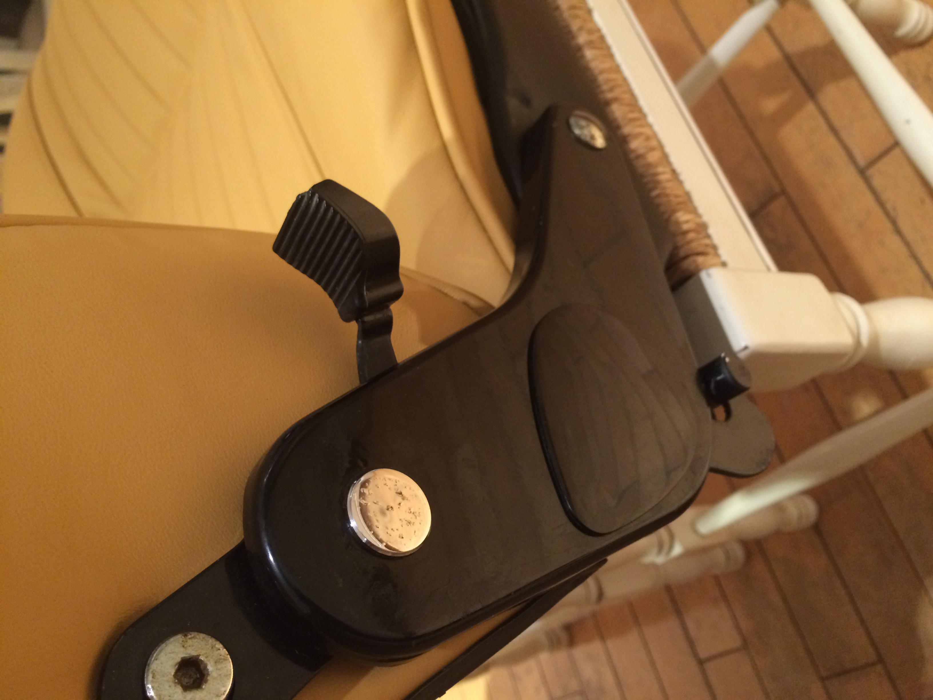

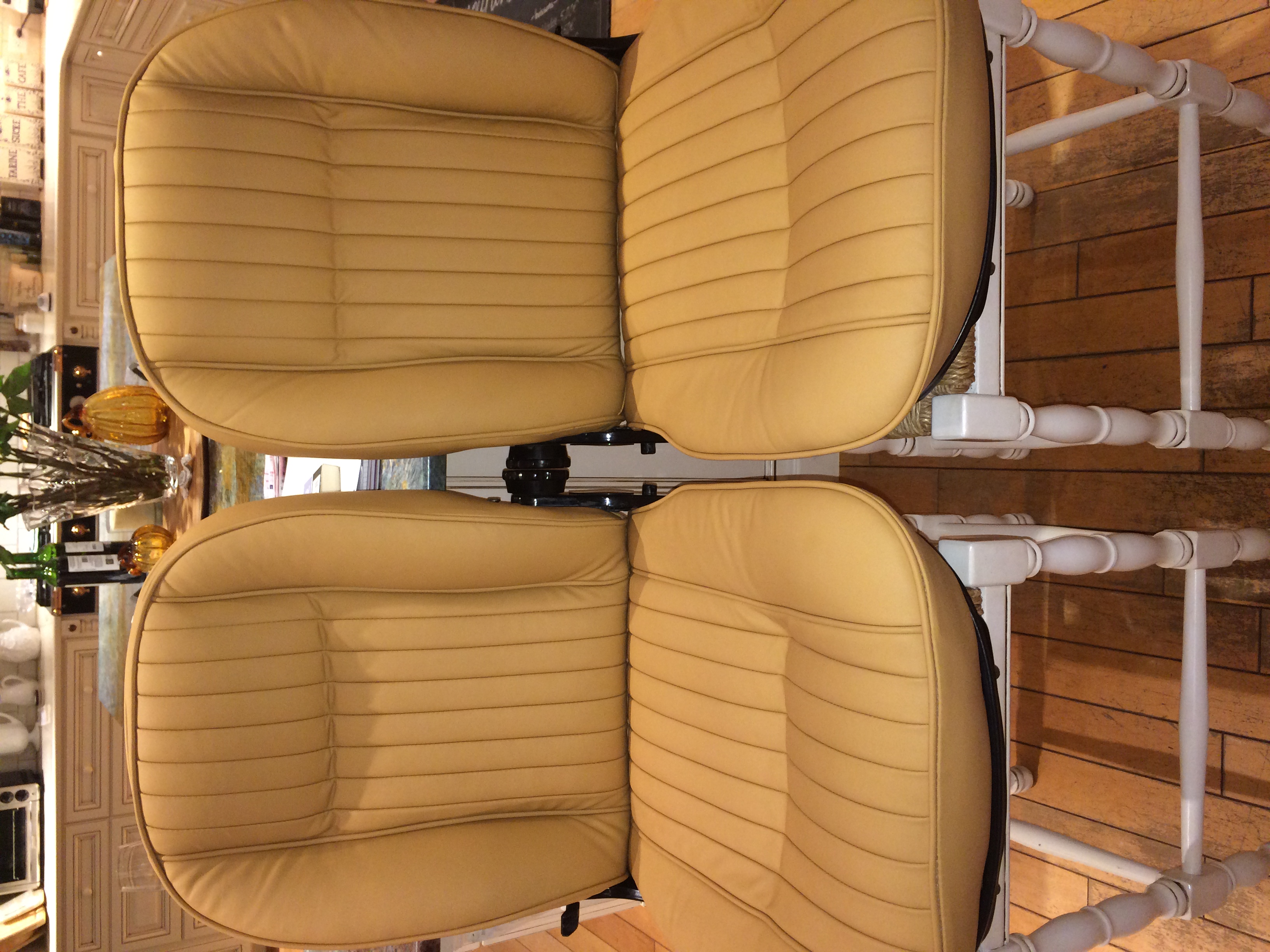

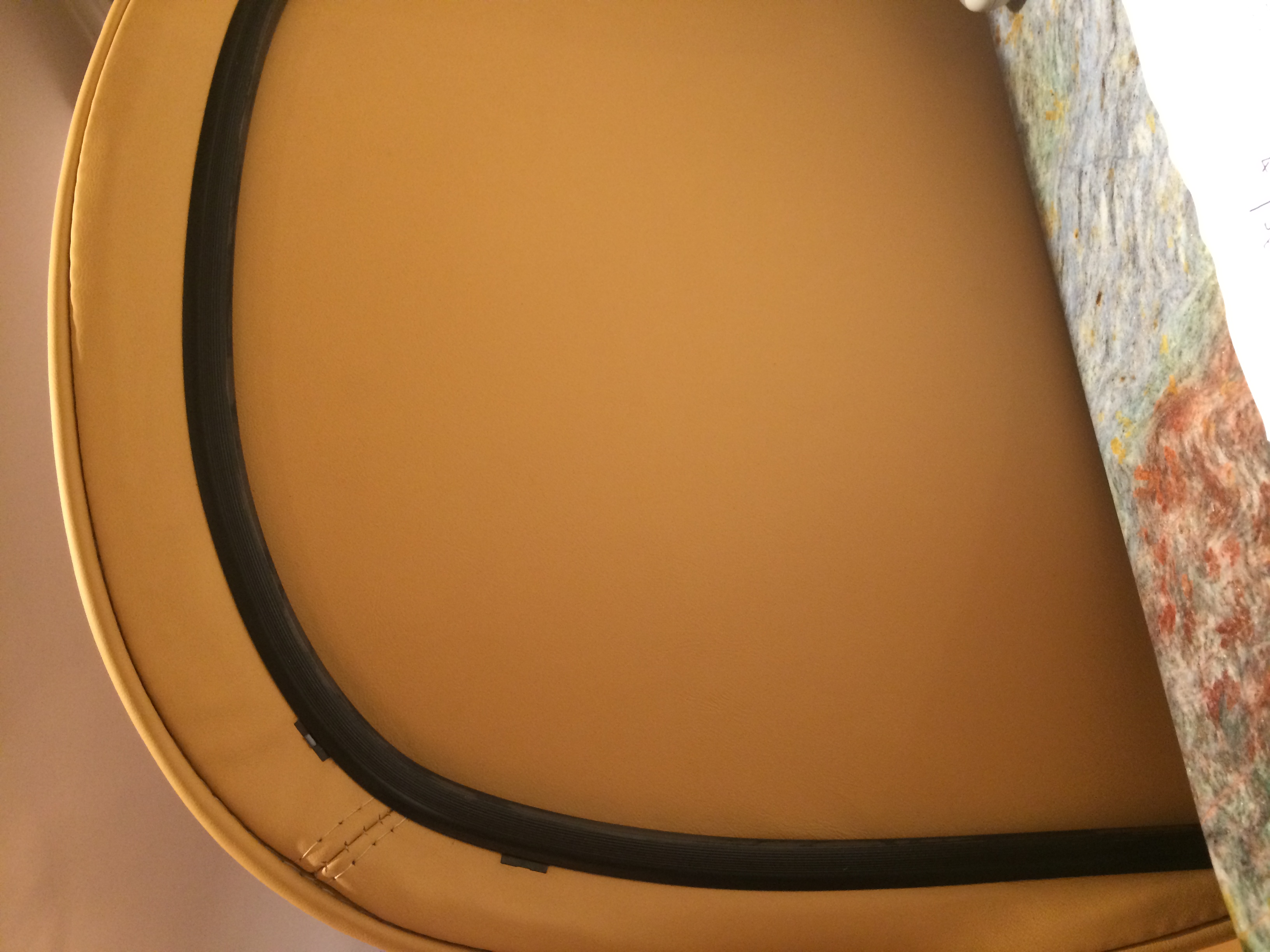

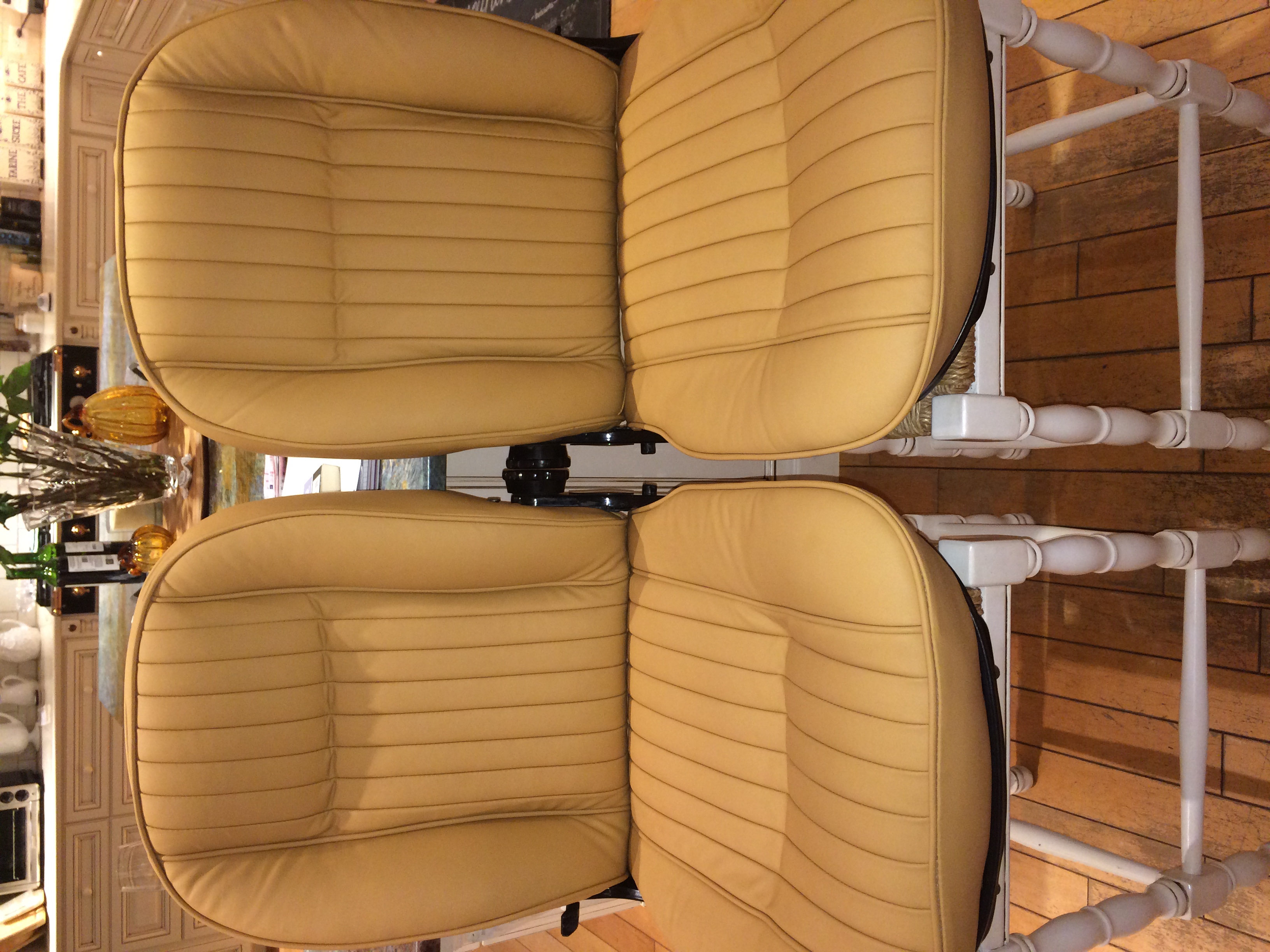

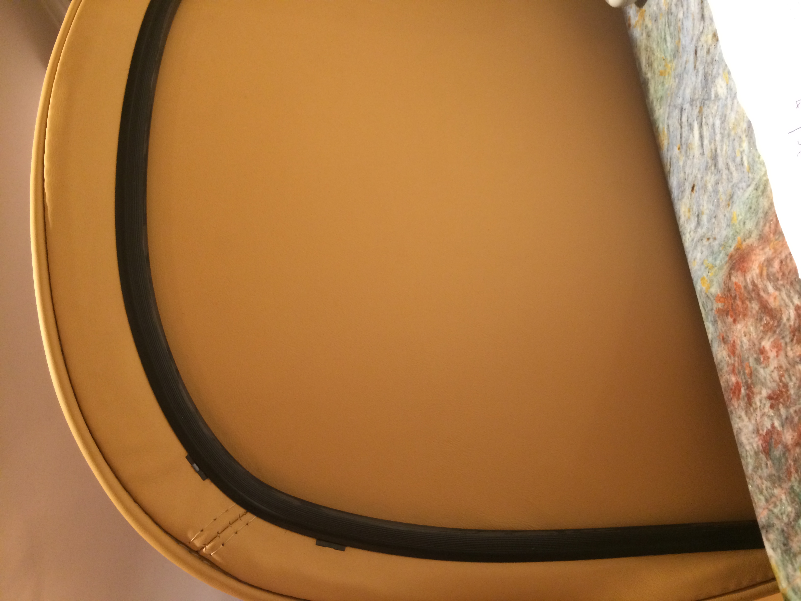

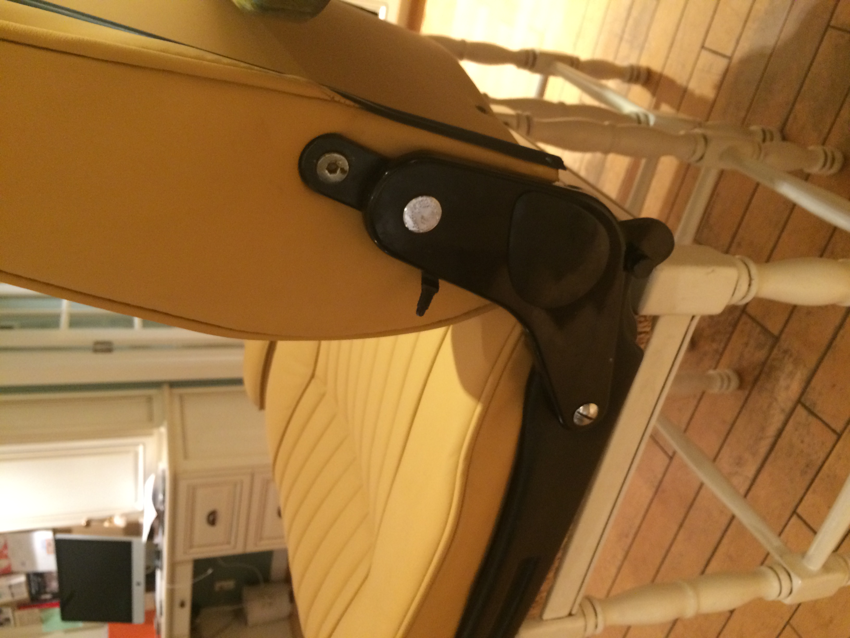

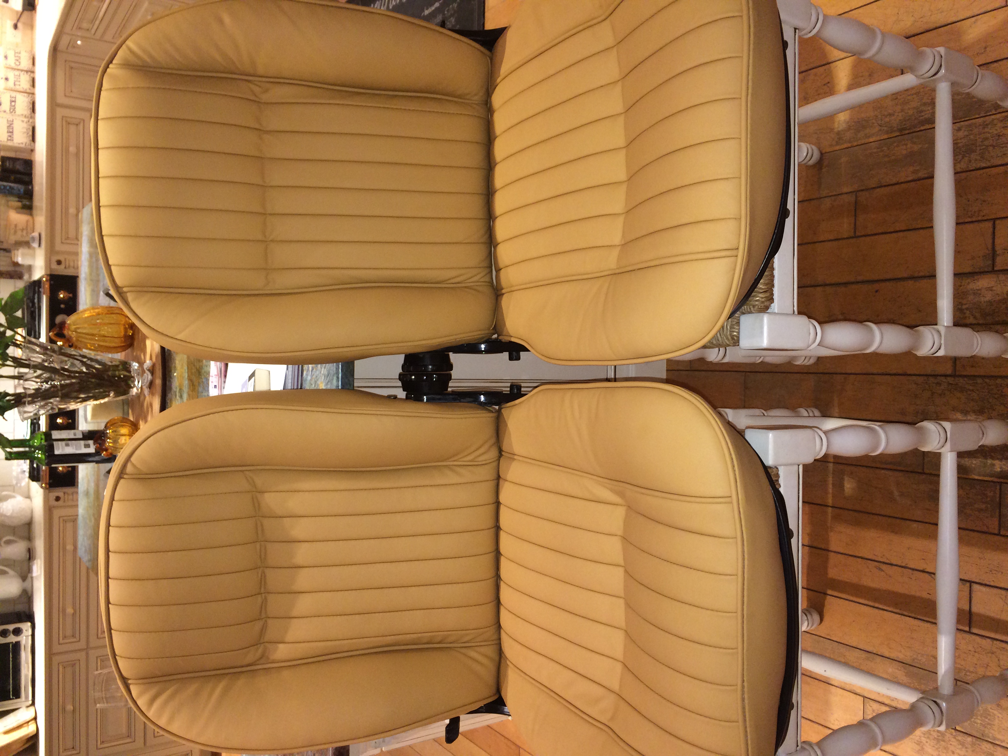

My two front seats are done. It took a while, but I wanted to be exactly the same as the originals.
