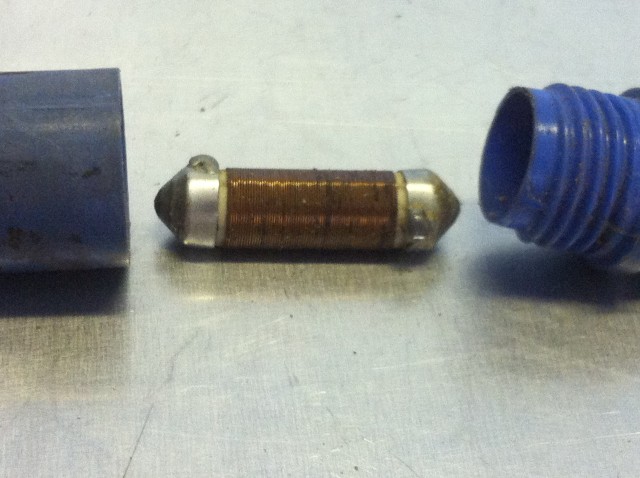

PS: Can someone tell me what is the purpose infamous blue fuse on the driver fender?

The blue fuse is in fact a voltage stabiliser for the instruments and takes a resistor. Complete new units are available.

As per the resistor. I figured out that the blue resistor is part of water temp gauge number 23.
Where can I locate the proper resistor? I believe it is a 100 ohms?

I must be going mad, I thought I saw a modern replacement resistor listed by Superformance, but now I can't find it! I'm sure there must be other FIAT/Ferrari applications. The main purpose is smooth out the swing of the gauge needle.
