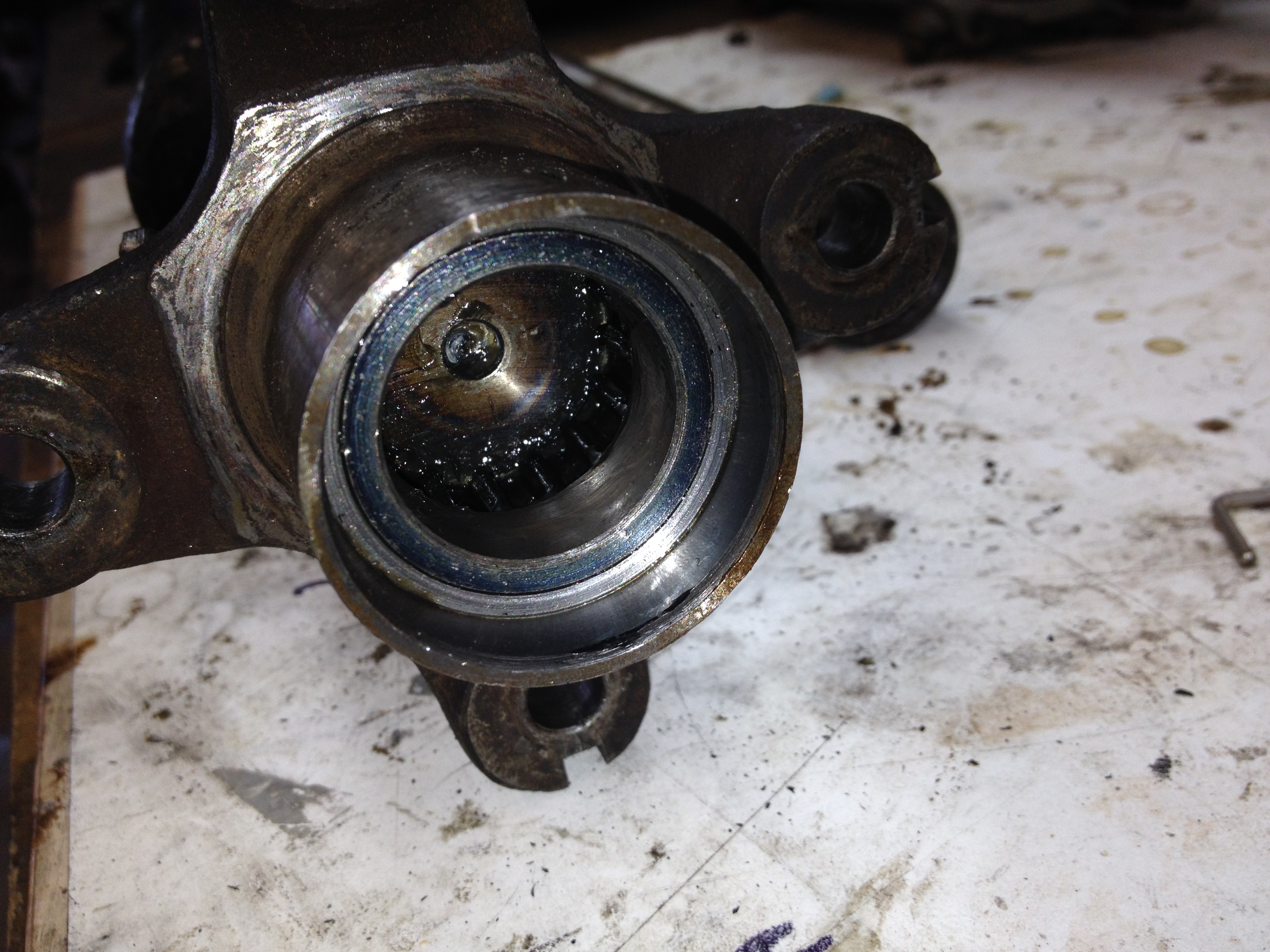

I finally had time to work on my car today - and so removed the drive shaft and torque-tube, again.
Now that I can hold the parts in my hands I can finally understand the pictures Georg sent - and the way the bushing/bearing at the very front of the driveshaft goes together.
Before I took it apart I tried to feel some movement between the driveshaft "nose-bearing" and the gearbox output bushing. I couldn't feel anything, but i'm not sure that's an adequate test, since I cant apply rotational torque that the shaft would normally 'feel' - and certainly not with any force.
So - taking it apart, I would say that they seem to be in good condition - on the driveshaft side, I do see some discolouration of the inside of the bearing - i can't feel it at all, but can definitely see evidence of use. Very hard to say how bad it is. I need to pull the front section off the shaft and push it onto the gearbox bushing - see how that feels.

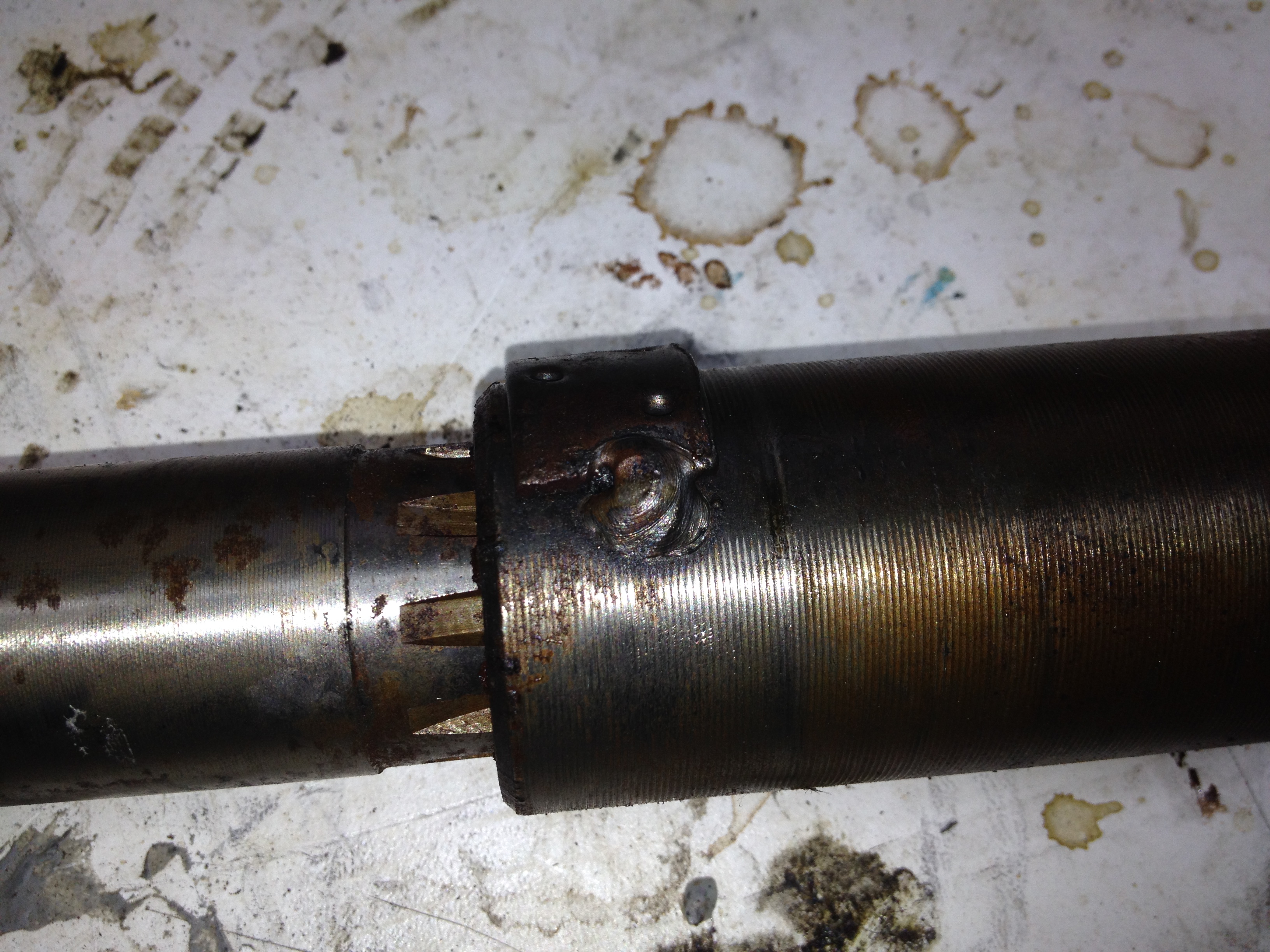

Here is one picture that worries me - on the far back end of the shaft, on the coupler that couples the splines of the shaft to the splines of the differential - there's is this balance weight - does that look right (doesn't to me).

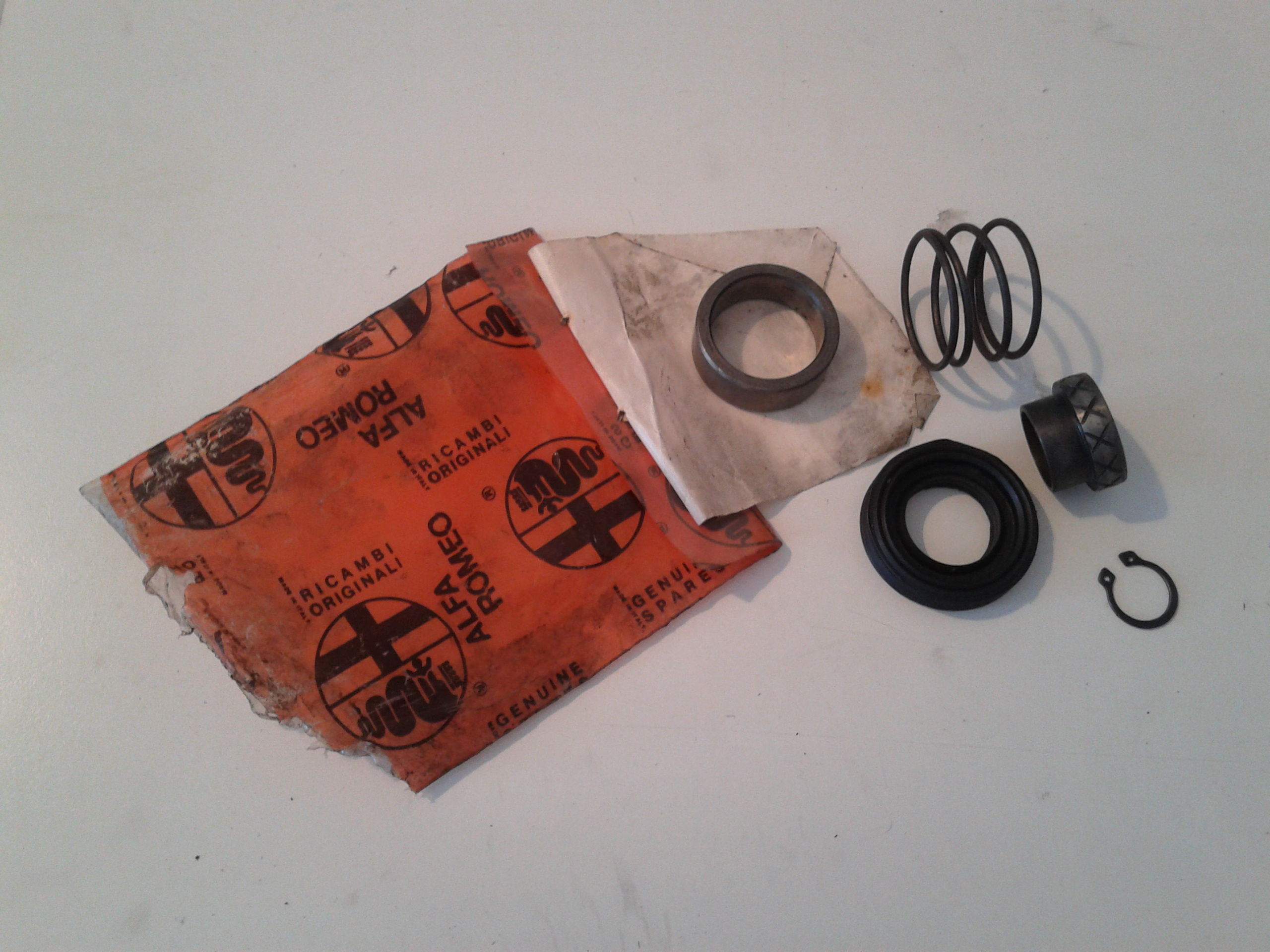

I'm still slowly working through this problem - the time since April has been spent looking for the unobtainable parts that fit between the gearbox and the driveshaft.
After contacting a guy who rebuilds ZF gearboxes in Italy I finally did find a set of NOS parts - pictured here:
Holding the new driveshaft ring over my gearbox bushing - and then pushing the new gearbox bushing into my driveshaft's ring - I cannot feel any difference whatsoever - in other words, there is a tiny amount of movement with the new parts assembled and it's exactly the same with my car's existing parts assembled.
By the way, I think these parts are from an Alfa Romeo Montreal, which did use the same gearbox and was built around the same time as our Dinos. I've asked someone to look up part numbers on the AlfaBB forum but nobody has replied with good info (yet)

Yes he was able to balance it, as a system. Removed the crazy weight on the splined-coupler at the diff - removed a lot of the other non-factory weights that the shaft had acquired over the years - and got it "really smooth" on the bench - all spinning as a full system.

By the way, someone did finally send me a page from the Alfa Montreal parts book and the bushing/bearing at the gearbox/driveshaft are NOT the same as the Dino. Oh well.
