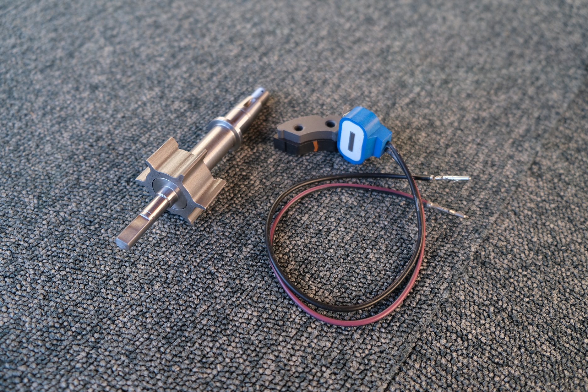

Attached a picture of what i use, the MSD magnetic pickup and a custom reluctorwheel that fits over a rigid shaft and over the 3 lobe cam, depending whether you use a programmable or standard MSD.

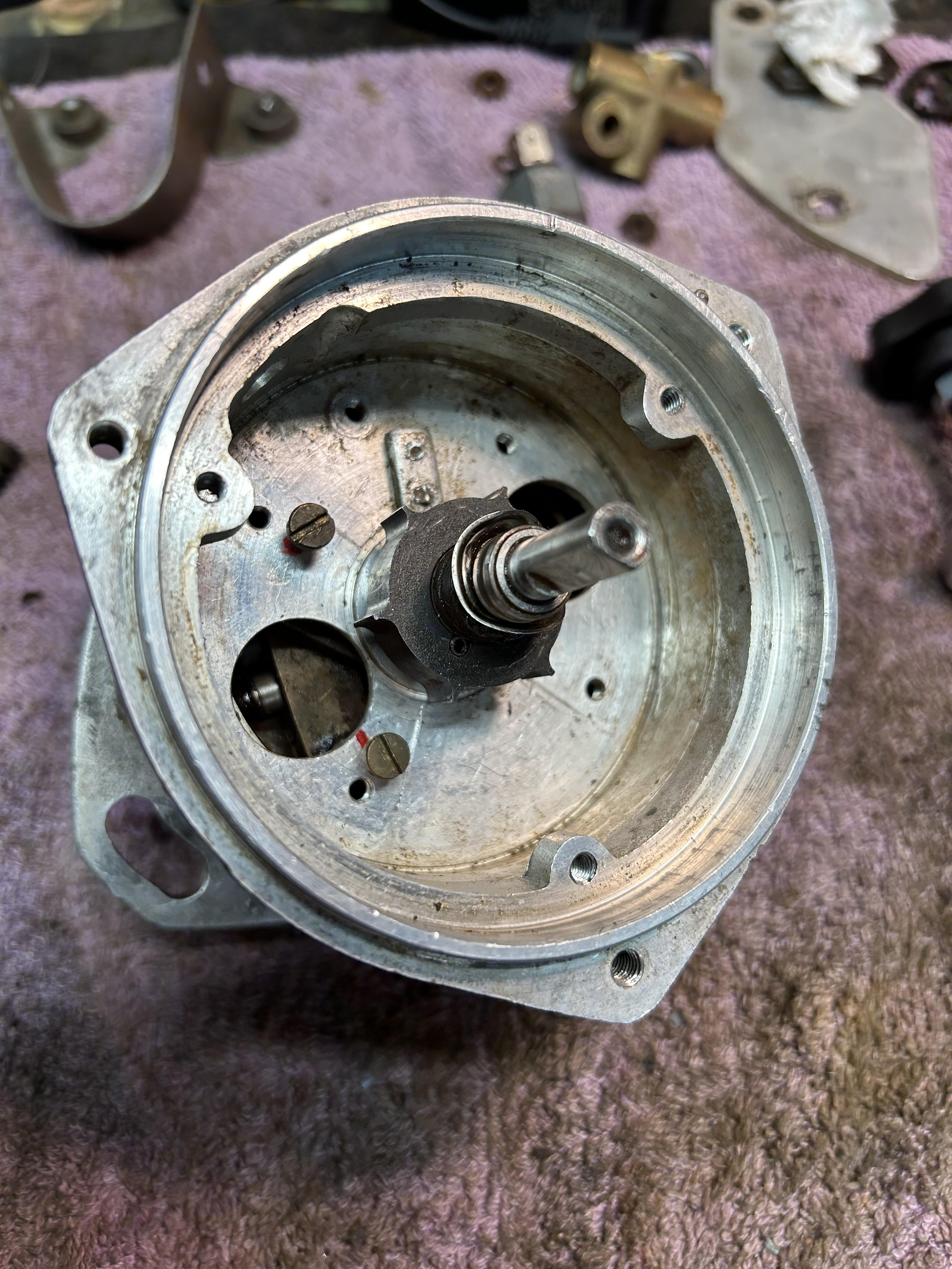

Attached is the magnetic trigger and reluctor in the distributor.

It does not really look like a genuine MSD magnetic pickup but more like a magneti marelli magnetic pickup as was used in many of the older italian cars from the 80's.
I would not be surprised if the actual MSD sensor has a better signal (at low rev's) while it comes with a big magnet underneath the sensor which i assume creates a larger magnetic field.
You could try to replace your sensor with a new Magneti Marelli one, or spend a bit more time and convert it with the MSD sensor. It could be that you cannot use your current reluctorwheel in that case but than i can help you with a new one that will work. Is your current reluctorwheel placed over the original 3-lobe cam or did they machine that cam in order to make it fit?

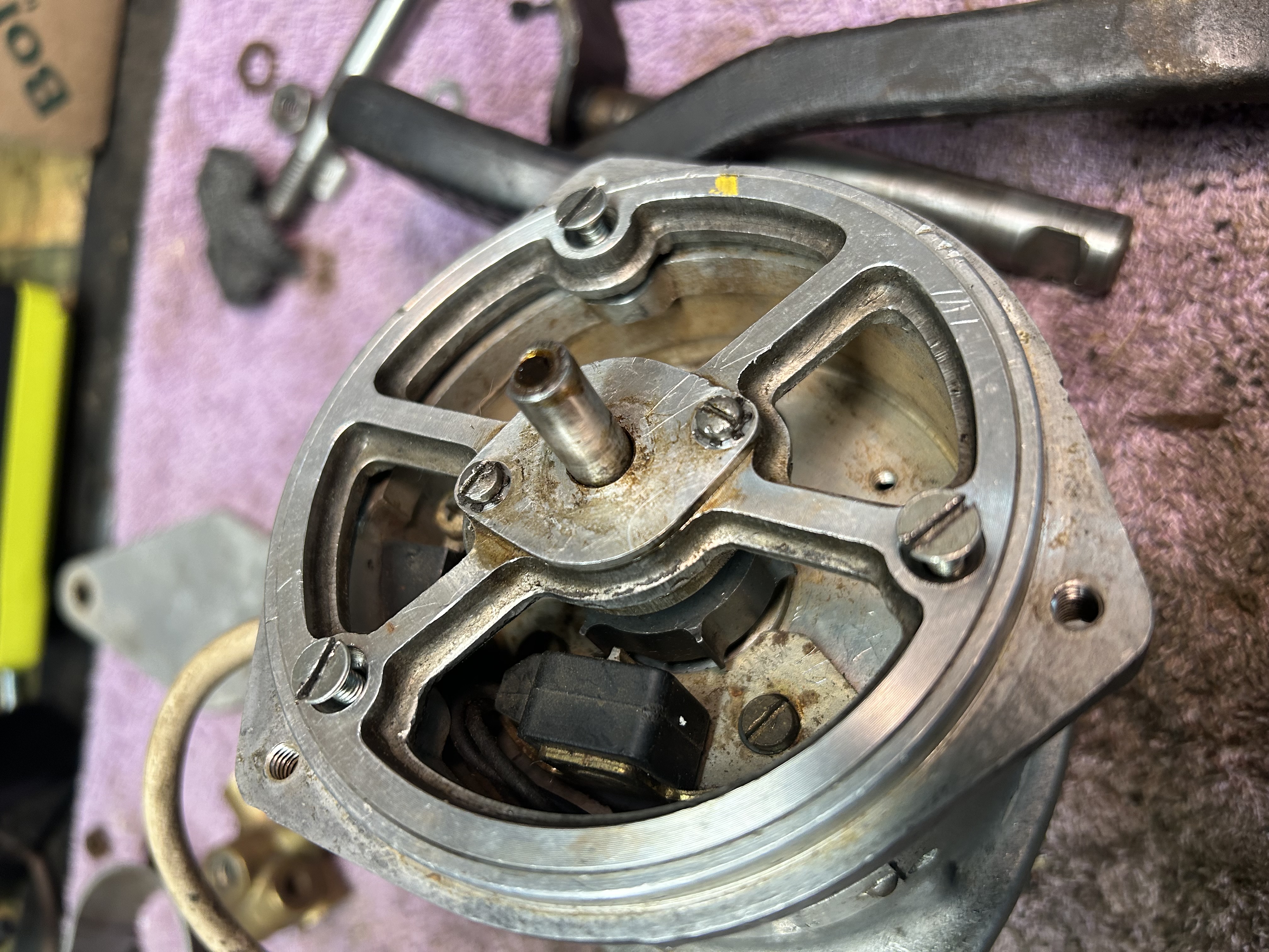

I'm thinking that the previous owner did quite a few modifications to install the components in the distributor. The circlip to hold the ball bearing on was missing and when I tried to remove it, the bearing disintegrated, leaving behind the collar still pressed onto the shaft.
Now that I have a clear view of the reluctor wheel, it appears to held on with some sort of roll pin. I'm not sure how to remove it. I'll post photos shortly.

Here is the photo. The spring pin/roll pin can be seen on the wheel at about 7 o'clock.
