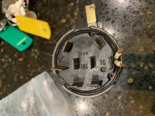

I finally tracked down a used ignition set 90030.
It appears to function and I’ve had the locksmith go over it and make new keys.
Can anyone tell me what these two white wires do, they have been cut off almost at the switch body.?
- Attachments
- Exit switch body just at the # 16 terminal
- 0223C06C-F721-440A-86F3-E1403BB6E8BE.jpeg (68.47 KiB) Viewed 29987 times

Re: Ignition switch Issues
I pulled the switch part of the lock set out. The two white wire are not connected to the switch, they continue down into the keyed portion of the lock. That is very strange to me. As there is no “Bianca” wiring shown in the wiring diagram, I’m going to seal these two wires with shrink tube and hope for the best. What’s puzzling is, it looks like original wiring?
Those wires are typically for a key-in-lock sensing buzzer/alarm.
As far as I know, our cars (edit: DID NOT) have that capability but your switch may be a replacement that was used in more modern cars with such a warning.
- Posts: 275
- Location: Central Portugal
Thanks Louis
I’ll stop loosing sleep over that one
