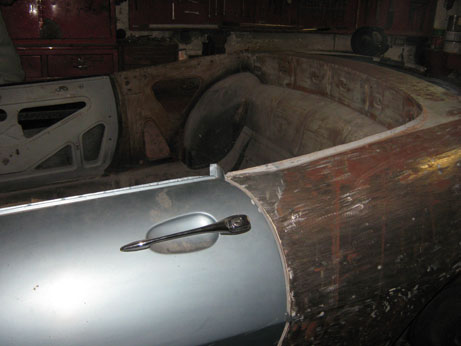

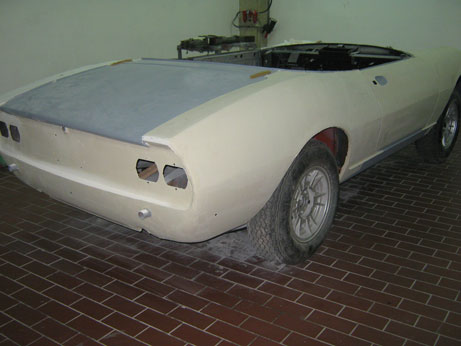

OK here are some more pictures. The car has had a number of panels remade, which make it look new not only from the outside, but also structurally

Progress

Fantastic resurrection. Did you have any major rust issues? Front of the car and rockers?
Re: Rebirth of a Dino
Posted: Fri Apr 25, 2014 2:55 pm
by Zorglub
Rust all over. Front of the car, rockers, floors…name any place and there was rust. The worst was in the sills, which had to be completely refabricated

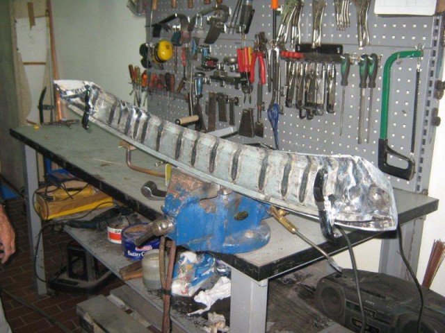

Another daunting project: fabrication of the folding hood.Only a few pieces came with the car : we had to hand build pretty much everything to fit the body
Front piece hand fabricated
