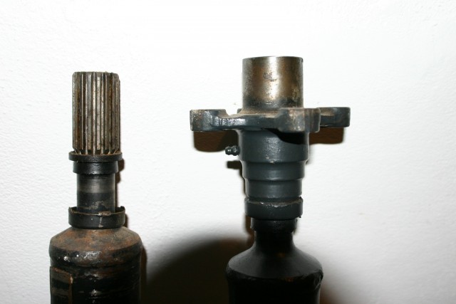

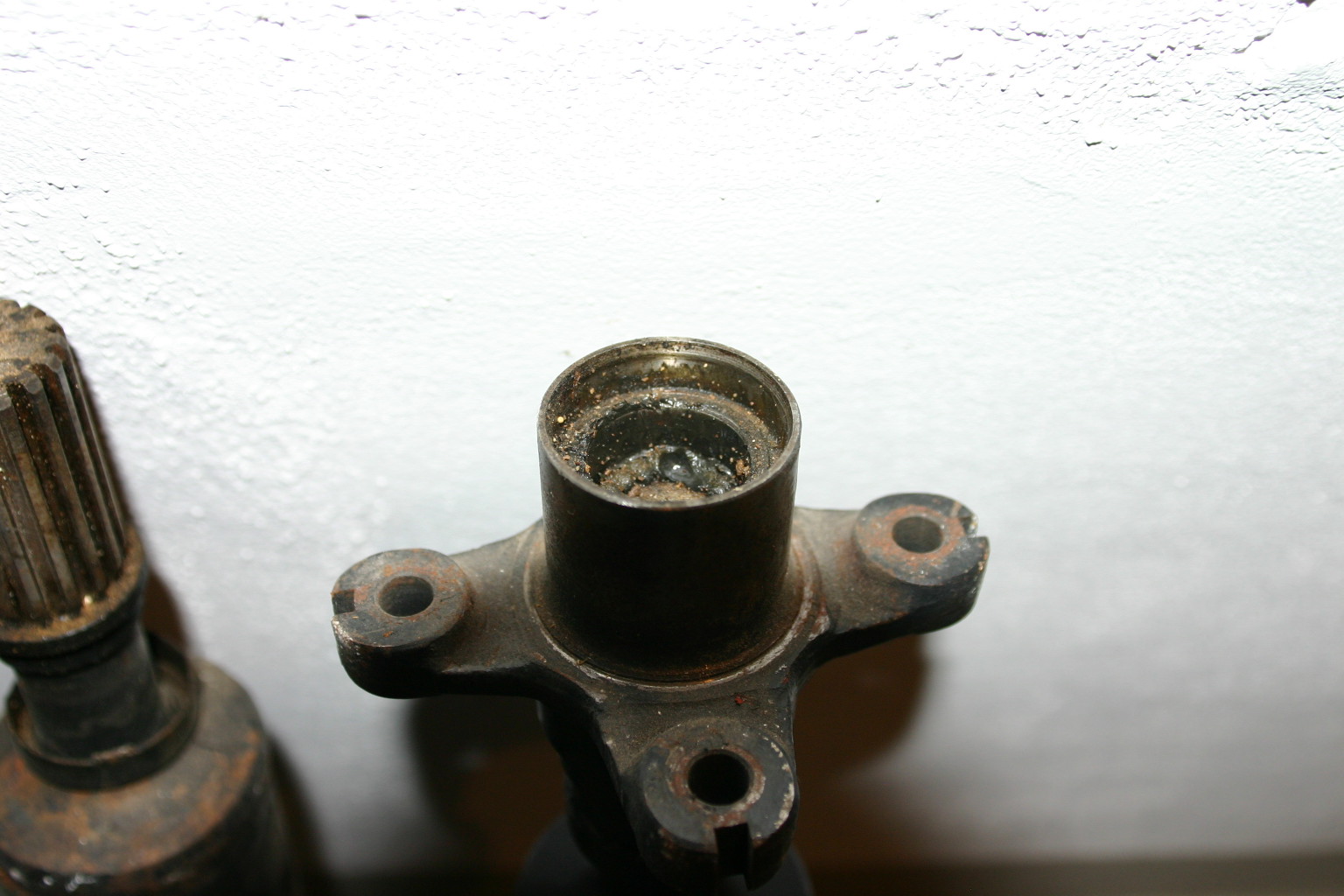

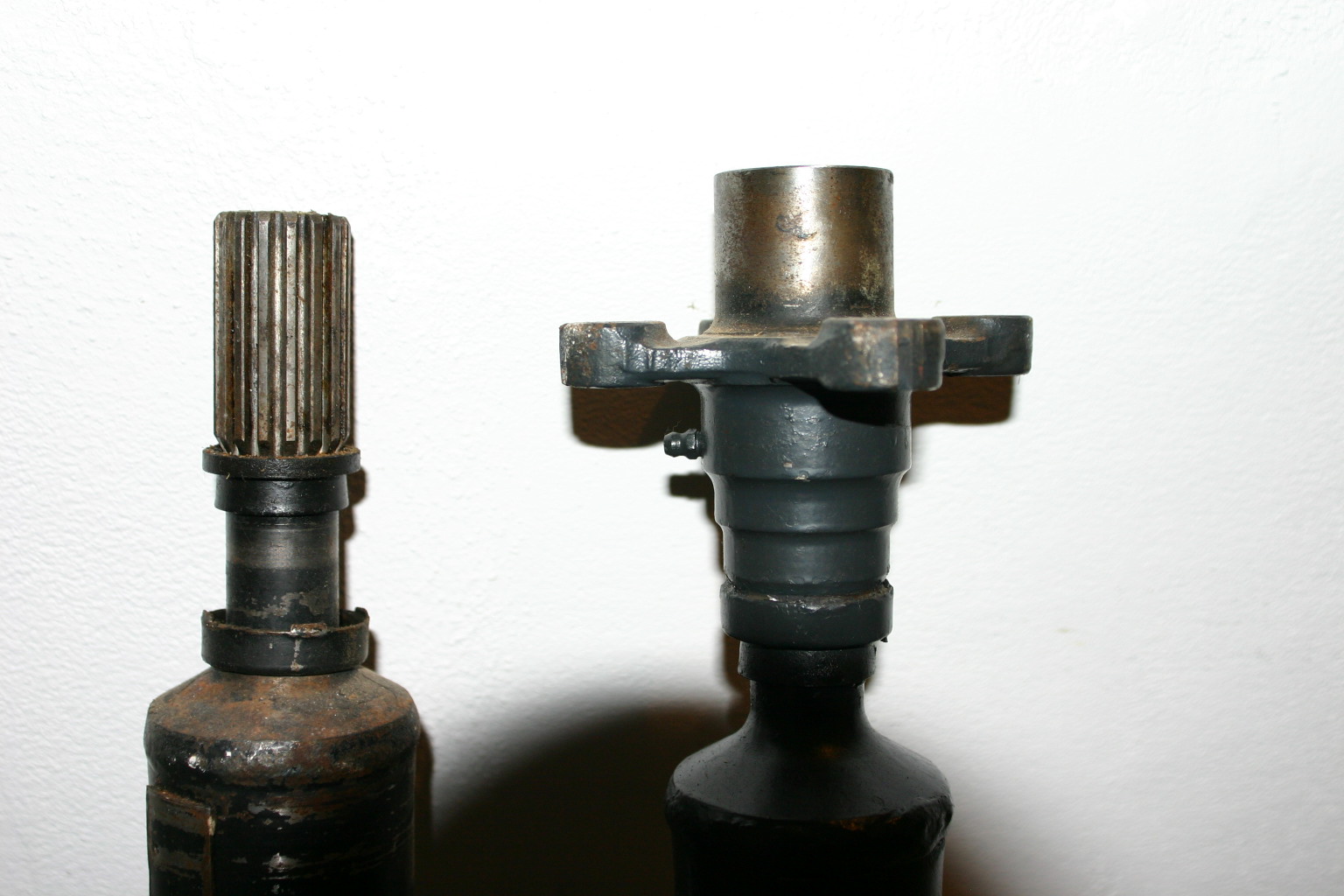

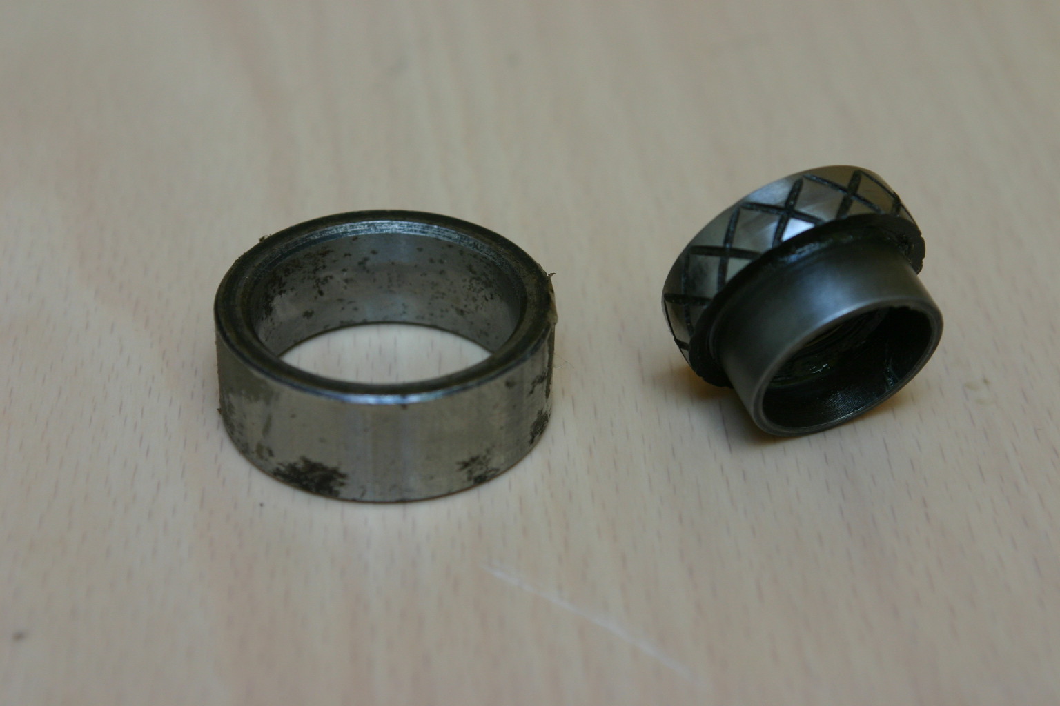

Posts: 220
Re: Fiat Dino 2400 Coupe - drivetrain vibration
Fotos of bush and spherical ring, indenting and casted shaft's front end and position of bush in casted front end

Hello Georg.
Thanks for your reply - that's very interesting information. I should have thought about this area earlier, because Alfa Romeos have the exact same problem. A spherical centering "olive" on the end of gthe gearbox output shaft, and a small circular bush in the nose of the propshaft. It's quite easy to replace the one in the propshaft - and requires a full gearbox rebuild to replace the olive.
On my Dino I never felt inside the nose of the propshaft as you suggest - I should have!. I just filled it with grease and pushed it back on. So I will look at that as soon as possible and replace somehow if it's loose. I really hope the olive is good...

Posts: 220
Hi Richard
Since January 2014 I have also a Fiat 130 that suffered from very strong drivetrain vibrations. The prophaft is identical to the propshaft of the FIAT Dino Coupé 2400 except for the length. The 130’s propshaft is about 5 cm longer.
Last week I have taken the 130’s propshaft to ELBE Gelenkwellen Service GmbH at Köln (Cologne) www.elbe-gmbh.de to have a complete refurbishment and balancing. I am very happy now since the vibrations have been eliminated completely by Elbe’s treatments.
The major problem was the front section of the propshaft. As the previous owner obviously never greased the front section there was significant wear of the indention (see my photos in earlier post). The front section is no more available. In the late 1990s GKN had them on stock, but they are sold out now. However, ELBE managed to eliminate the wear. They also replaced the universal joint and the ball bearing. The price tag was significant (EUR 520) but the result is convincing.
My recommendation is: send the complete propshaft (front and rear section) to Elbe. Their experience is sound; they will return a zero vibrations shaft to you. Should the bushing in the front section need to be replaced I would borrow my last one to ELBE so they can copy it. I am not sure if these guys at Elbe speak any English, however, I would help as a translator if necessary.
