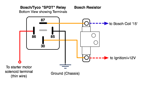

the Super4 ignition is actually a clone of the early seventies Bosch TSZ, the output is exactly the same as a points and coil ignition, e.g. not really sufficient for running the Dino engine. I would recommend getting something with more output, as example a MSD 6A/Blaster 2, a Crane XR3000 or a high power Bosch conversion. (All of these can be fit into a Dinoplex AEC101 or AEC103 enclosure).
With the Super4 in place, you could short-circuit the ballast resistor of the Bosch red coil while starting (this is the primary reason why there is an external resistor). To test if this approach works, short circuit the grey white Bosch ballast resistor with a wire, then try to start the car. Remove the short circuit wire after the car has started (else the coil overheats after some minutes).
If this works well, you might want to add the components/wirings as in the circuit diagram below. This short circuits the ballast resistor every time you turn the starter, enabling a hotter spark. I recommend NKR BPR7EIX spark plugs for the Dino engine and a transistor ignition setup.

alh wrote:Hi Brian,
Best,
Adrian
Hi Adrian,
We changed the wiring to your suggestion, although we bypassed the electronic ignition, and have temporaily gone with a points and 12v coil. The hot starting is much improved (and the cold starting also), so must've been a weak spark issue. I now have a rev counter that bounces around all over the dial!. Do you think that I'd have the same spark strength if I go get the car rewired over to the Dinoplex again.
Thanks, Brian
