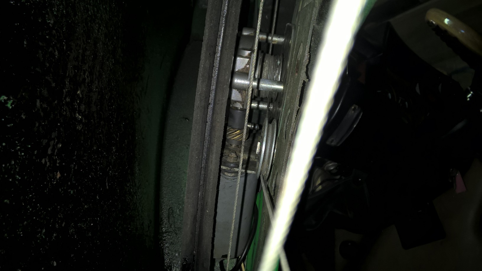

Then left electric window, cable is not proberly in motor's winding drum, where to find pic how it supposed to be there? How to remove motor and cable drum?

Here is pic of cable routing now.

Window regulator repaired and tail lights repaired (glued), Interior vacuumed and washed. Now its comfortable to sit in :)
