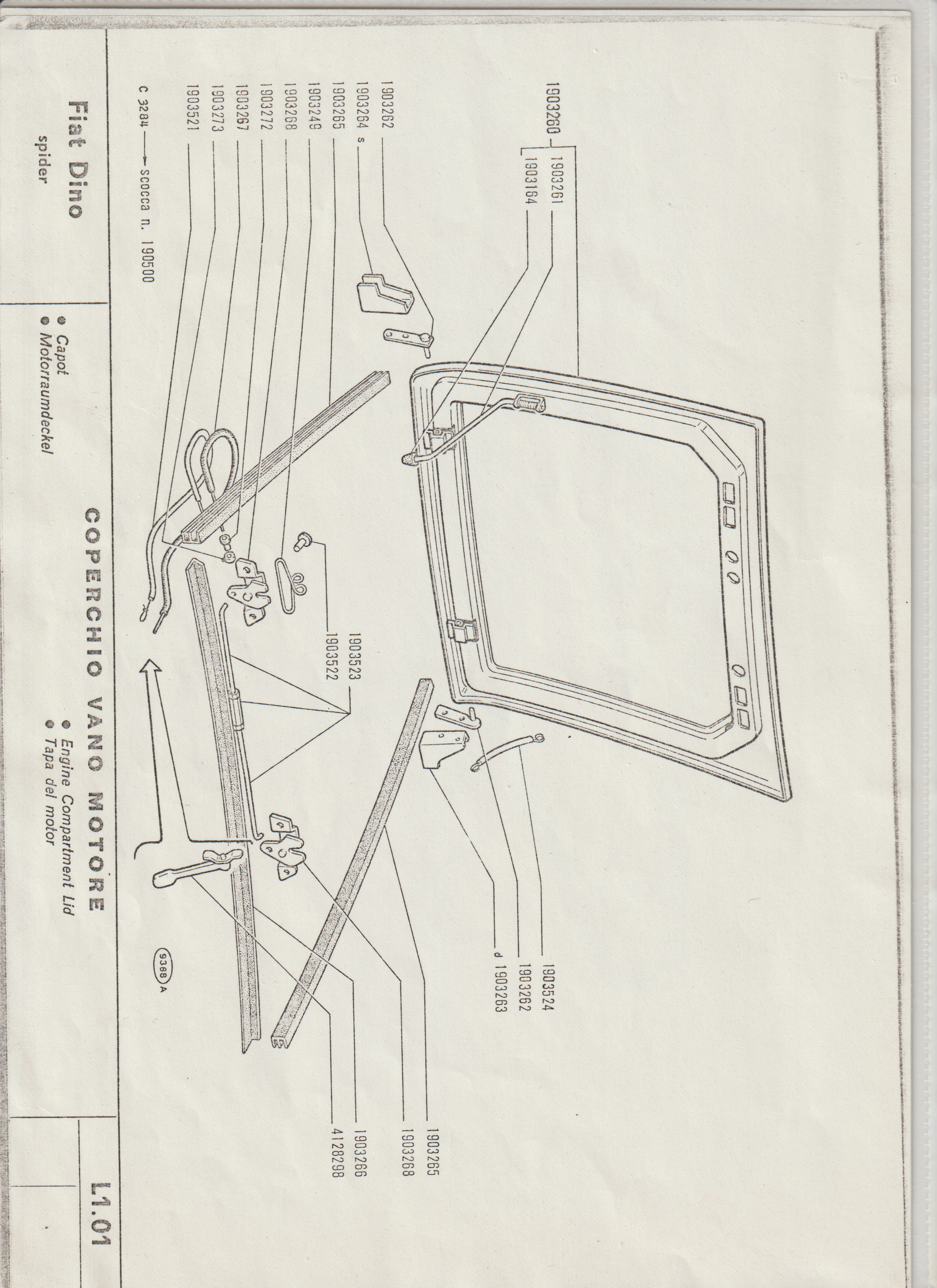

The Pininfarina emblems for a 2 Litre Spider were always placed at the front fenders. For the 2,4 Litre Spiders, FIAT moved them
to the position at the rear fenders, between the doors and the rear wheel arches. In other words, they are mixed up on your car!
No 2 Litre Spider had any padding underneath the bonnet. It was added at the 2.4 Spiders. See the 3 spare parts Catalogue pages
below: (Sorry for the pics are not shown in correct angles!)

Wow that is awesome information! I have seen the parts book for the 2.0 and it did not show the blanket but I have never seen the 2.4 parts before. This is what I suspected but its great someone can confirm.
I wasn't worried so much about authenticity as I was technically. I worried there was an engineering purpose to the blanket.
