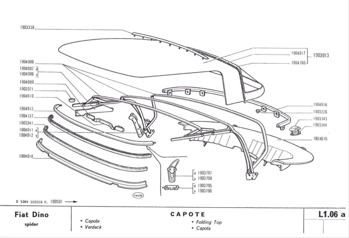

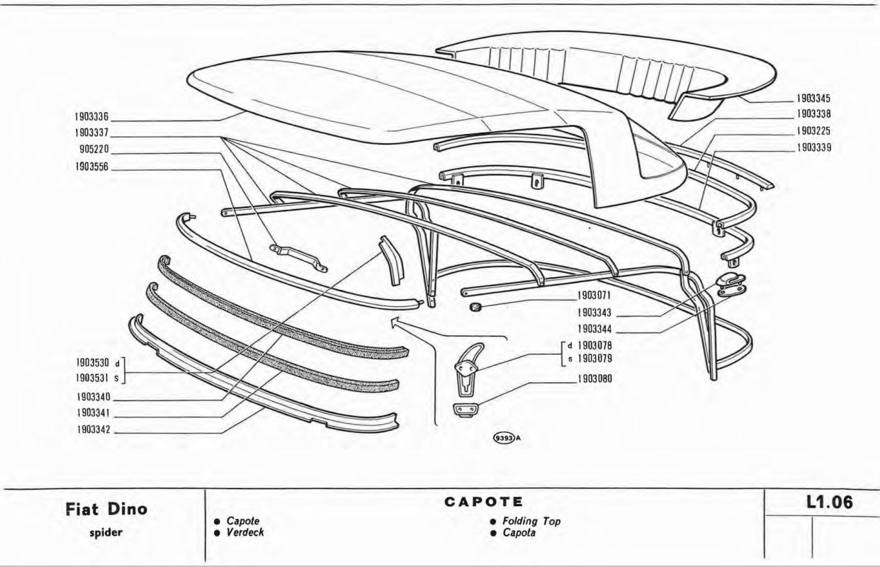

In the early '67 cars, if you look at the parts book, there was more than one top bow assy. I don't know the differences, but I suspect the top must correspond to the bow assy. When trying to source a pre-made top, this detail was not generally obvious.

It should be noted that there are 2 different types of top linkage on the Dino Spider 67...
