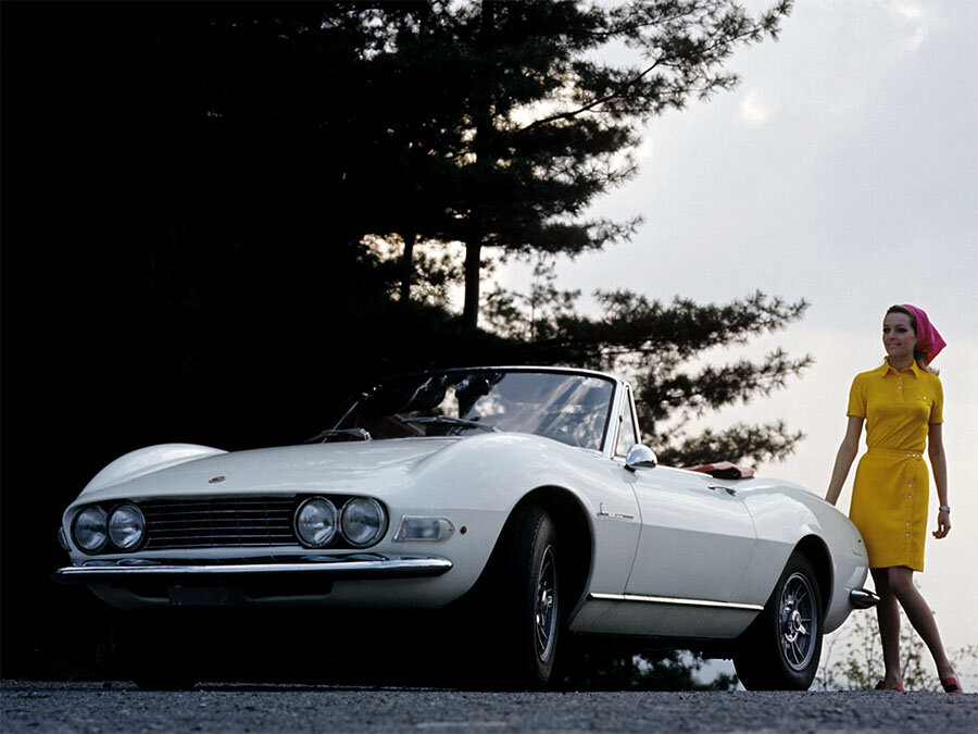

Here some more pictures of „Prima Serie“ spiders (the first 500 spiders for Formula 2 engine homologation purpose.)
Literature says that most of them were sold in northern Italy around Torino simply to keep maintenance and maturity issues under control. Regular european sales of the spider 2000 started with the series 2.
