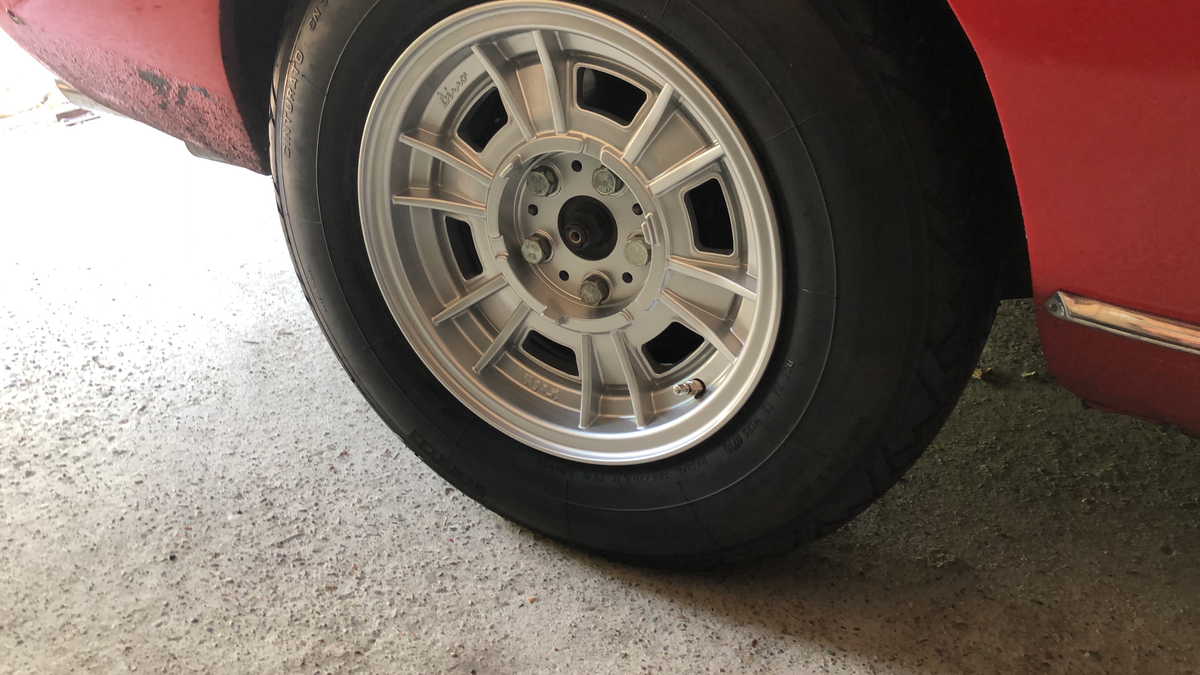

Well, finally got the new wheels on! It turned out to be quite a saga.
First we got some substandard quality ones, before receiving some very nice ones from Dinoparts. The real fun started when we found out two of the five holes (and original wheel) on the right rear were drilled out to a bigger size. Drilling out the brand new wheel to a bigger size was off course a definite no go, as you can imagine! So I got a wheel bearing carrier with hub with stock treads. See if you can spot the difference from the attached picture. I didn’t notice until I tried mounting the brake caliper!
Turns out it’s for a Fiat 130, promptly received the right one from the seller and managed to put everything back together this morning.

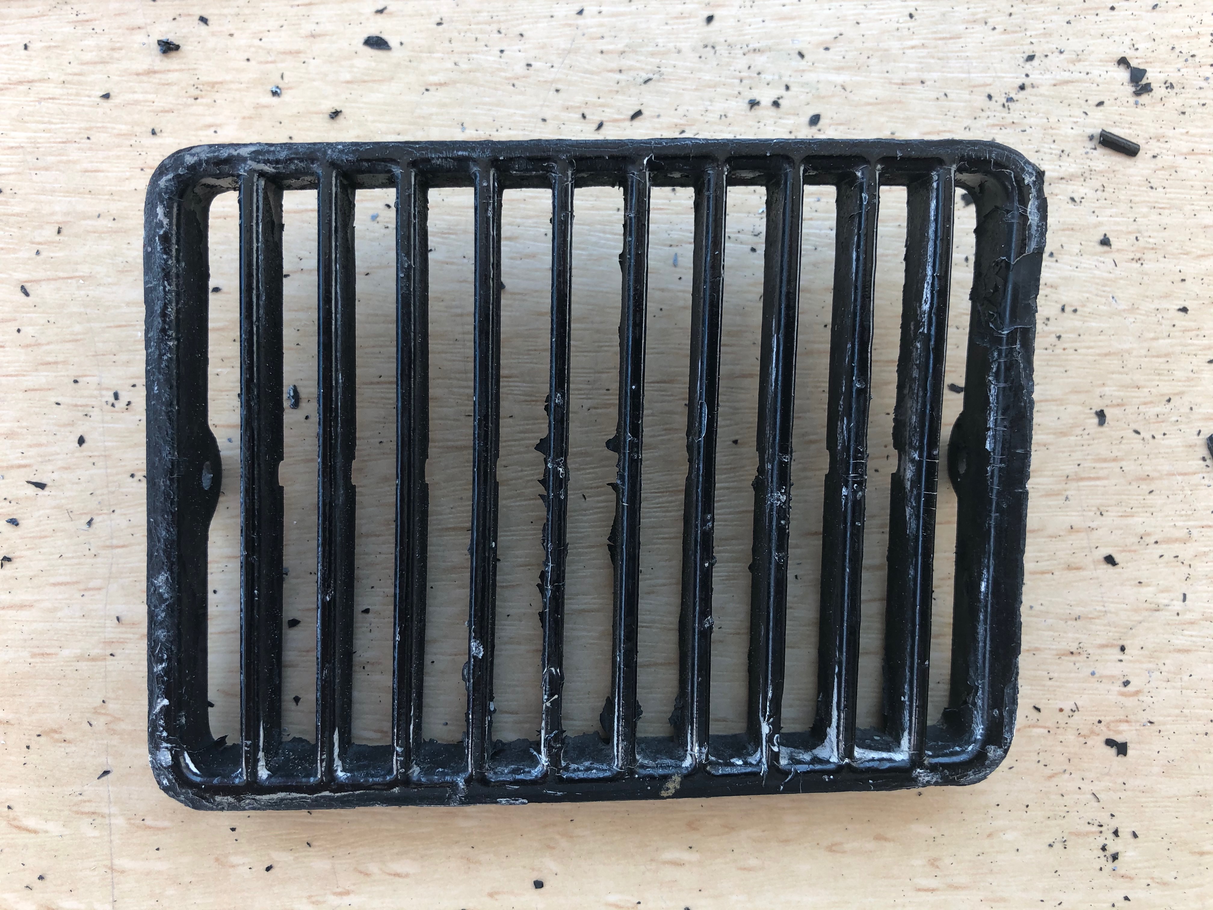

As you can see, it’s quite a difference, but it also meant the hub caps would look out of place… So, I got to work, not perfect, but using a cordless drill I wasn’t going to do any better.
Before and during:
Result: Also made the grills and emblems look a bit better (yes, some idiot drilled holes through the emblems!).

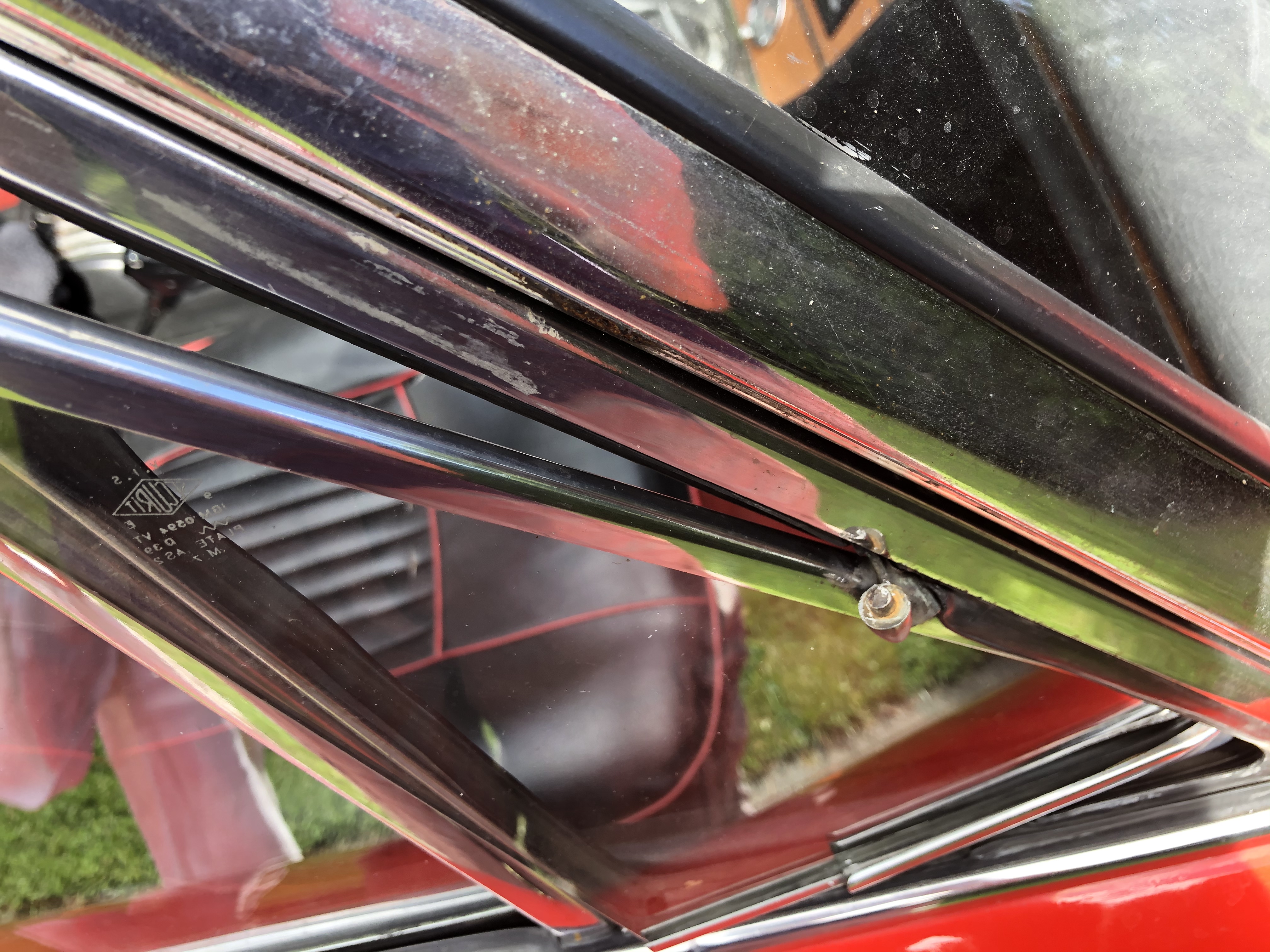

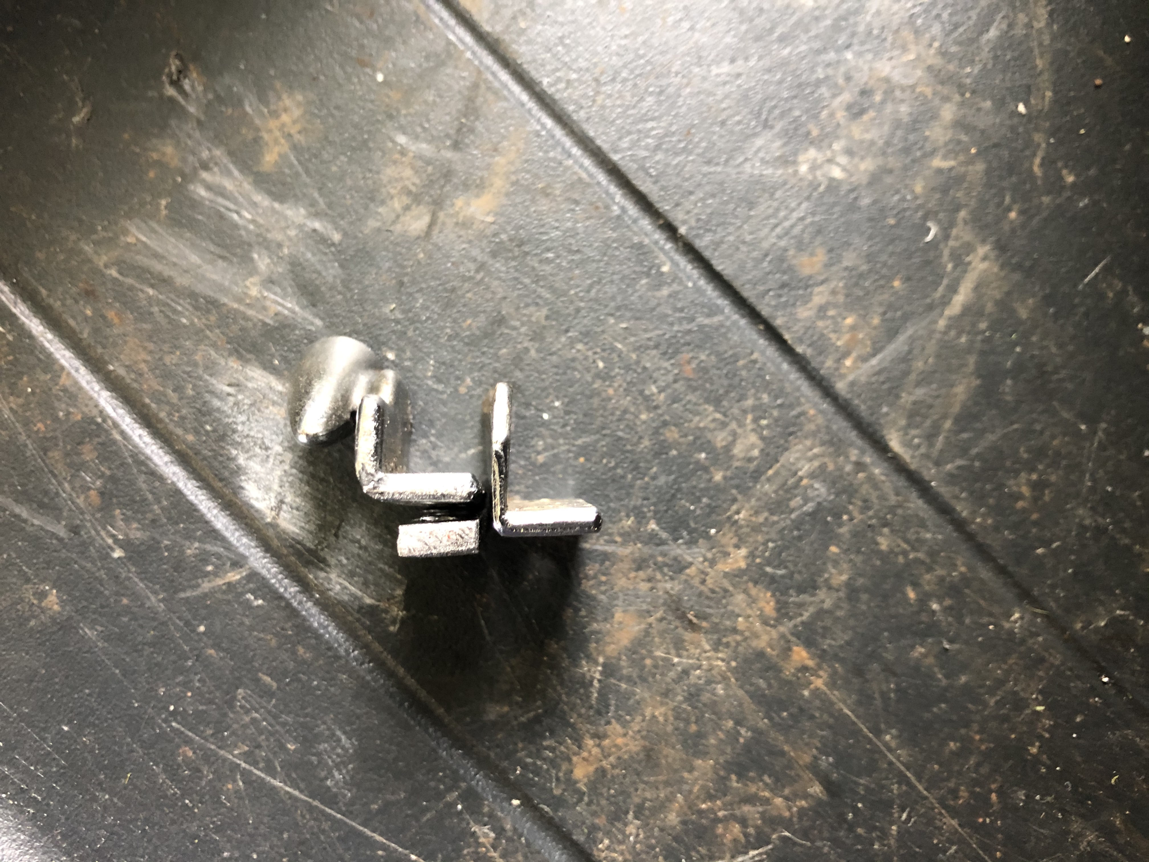

The passenger side vent window had been missing half of its hinge since we got the car.
I bought a 124 Spider vent window thinking it used the same hinge, it's not... So I made a small spacer from some spare sheet metal I had laying around which happend to be the exact thickness needed .
Yes, I know the last picture barely shows the actual 'new' part of the hinge .

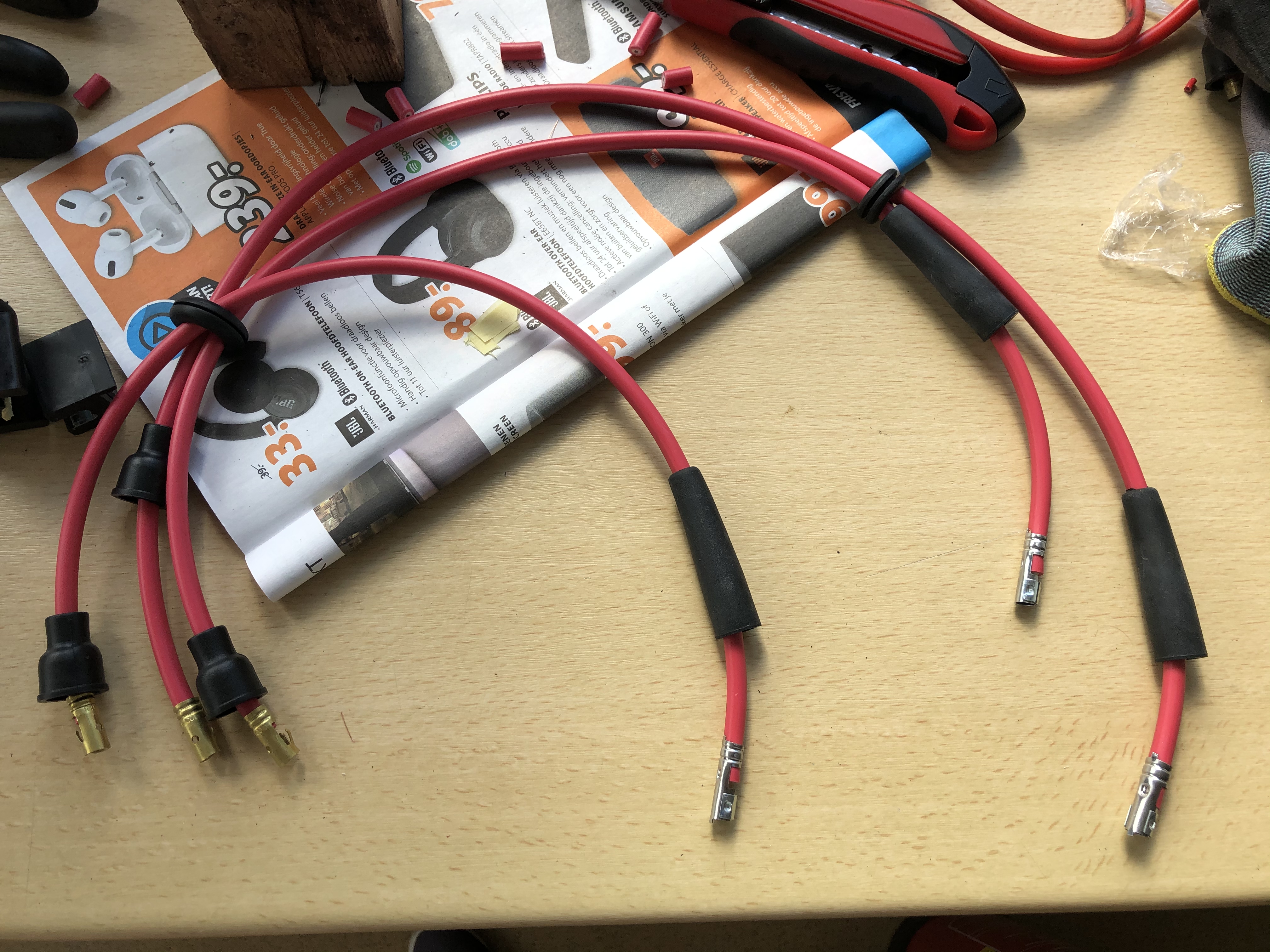

Furthermore I changed the coil and spark plug wires (made my own), both were looking a bit tired!

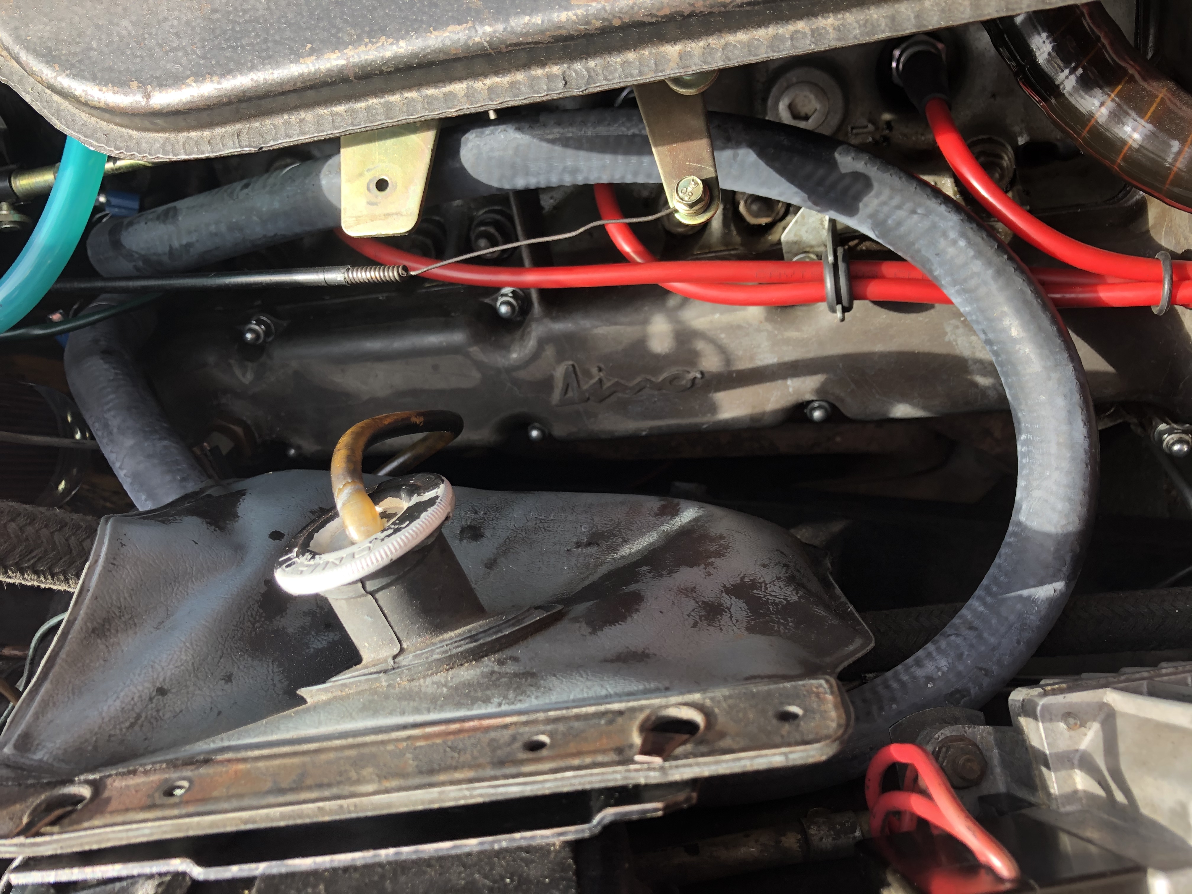

The last job was to change the water temperature sensor and hose I used last year to block of the heater system. At the time I didn't have an appropriate bend so I used a long hose, which took up quite a bit of space in the engine bay.
It turns out the heater hose for an - I think - Iveco of some sorts has the perfect 180 degree bent needed.

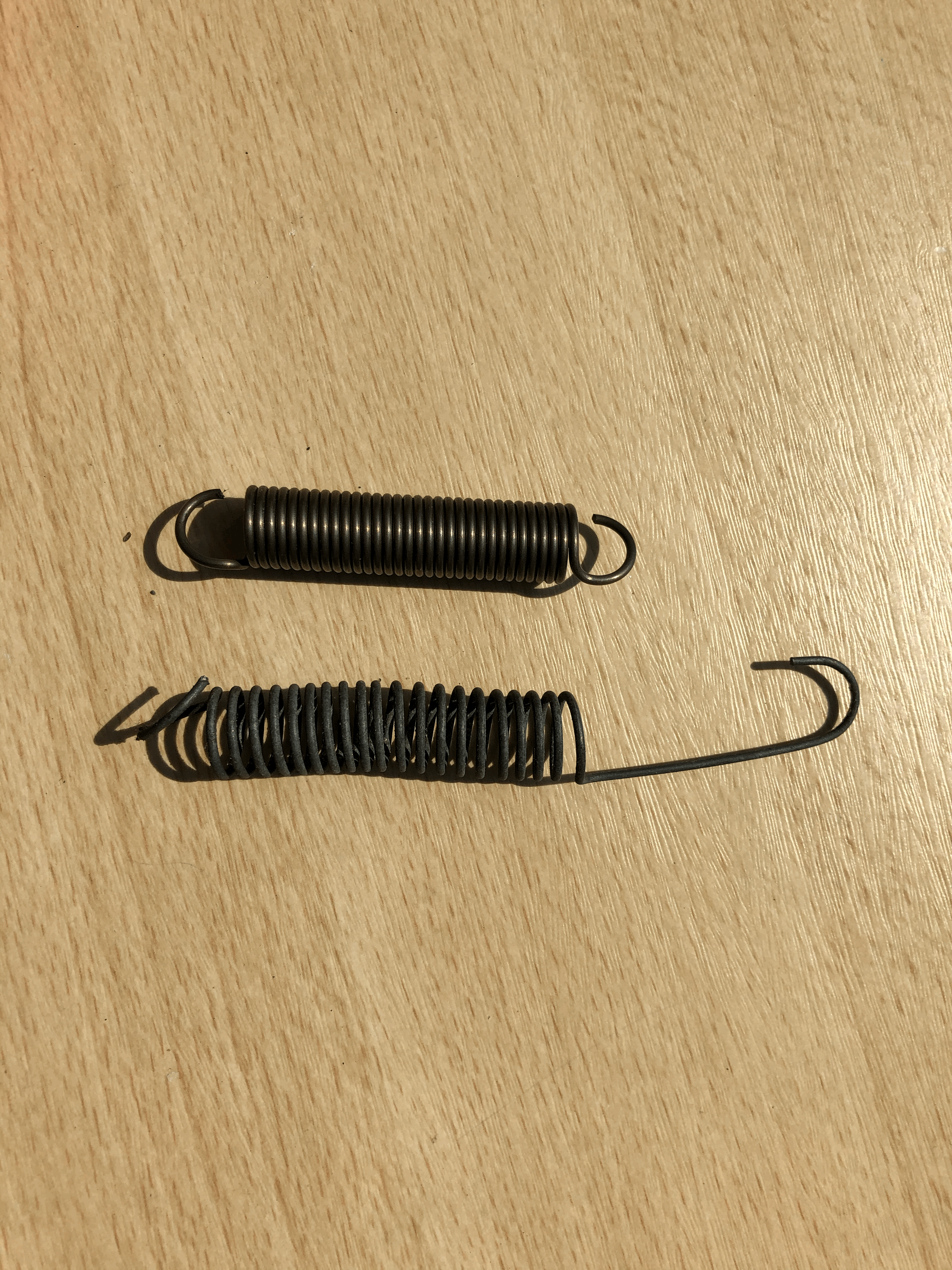

Also changed the clutch spring, massive improvement in pedal feel. The spring that was on it didn't even do anything and was not original I suspect. I think you can tell which one is new...
