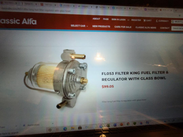

I want to know if the fuel bowl in the picture from Classic Alfa is compatible with the 67 spider. I want to replace my old bowl for the hazardous reason. Thanks in advance.

Post by Scalino »
Yes, that will work fine. The Fispa unit that is on your car were also used on Alfa 105.
1967spider
Posts: 63
Re: Fuel filter bowl
Post by 1967spider »
Thank you Scalino. I will place an order today.
