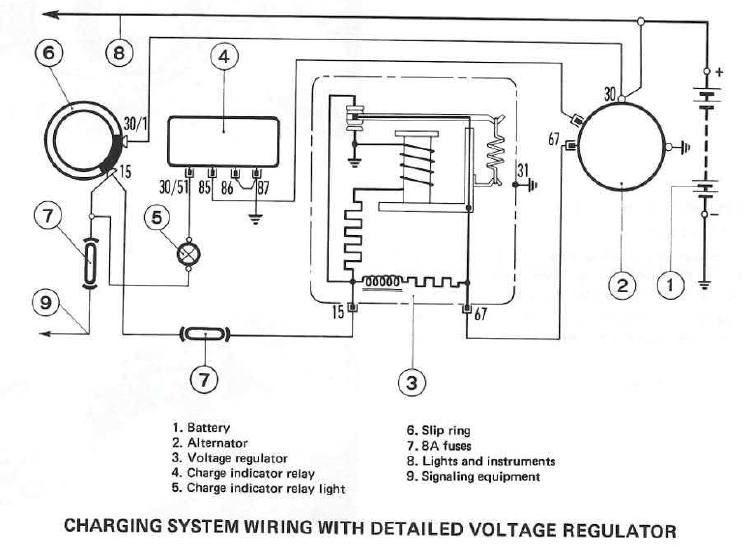

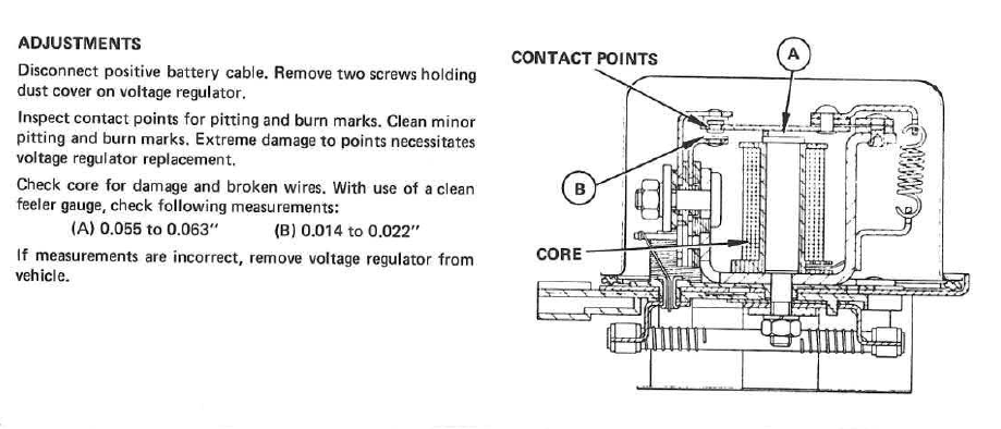

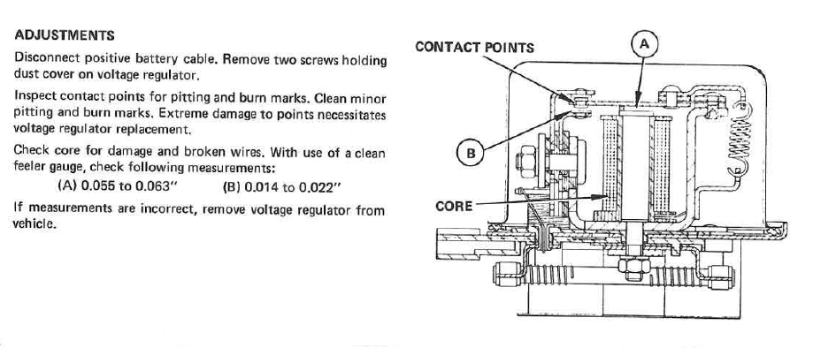

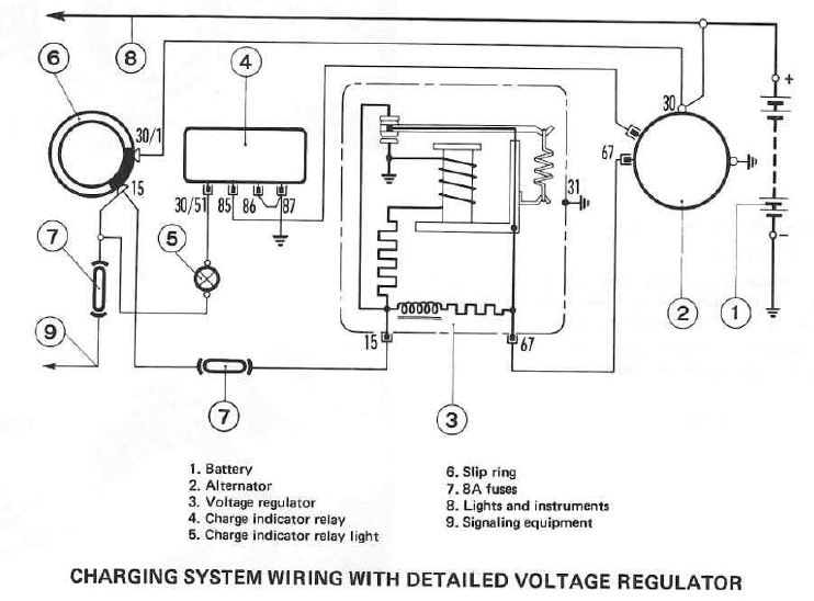

Hi everyone, I recently realized that my 2400's alternator was putting out too high of a voltage. The specifications call for 14.2 +/- 0.3 Volts at 5,000 RPM. I was running as high as 15.7 at times. Mechanical voltage regulators can be adjusted so a little bit of internet searching led me to a website with a shop manual for the Fiat 124 of the 1970's which uses the same type of Magneti Marelli regulator our Dino does.
Three pages of the manual have a very complete explanation of the adjustment procedure. in English, that I am attaching here in case anyone needs it.
I was able to successfully bring the voltage down to the specified range of 13.9-14.5 . I will now monitor it to see if it doe stay in that range or if maybe the regulator is somehow defective and it drifts away from these values with time.
Here are a couple of snapshots from the document:
