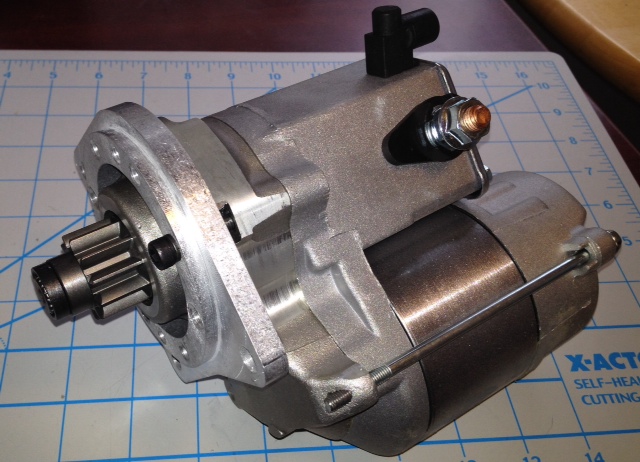

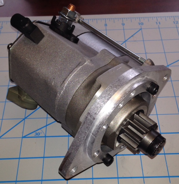

It won't be going back in for some time (engine is currently out while the car is being restored), but here's what the starter looks like:
photo 1.JPG (131.86 KiB) Viewed 20392 times
photo 2.JPG (116.23 KiB) Viewed 20392 times
photo 3.JPG (159.22 KiB) Viewed 20392 times
photo 4.JPG (129.18 KiB) Viewed 20392 times

Thanks Josh. great pictures.
Is this the type where the body can rotate around the mount? - it looks like it might be with that black set screw.
And is this one permanently engaged or does it have a "throw-out bendix" (not sure about correct terminology) like the original.
Looking forward to hearing about the installation - thanks again.

Pretty sure it uses a typical "throw out" mechanism, and yes it looks like it can be clocked at various angles.
