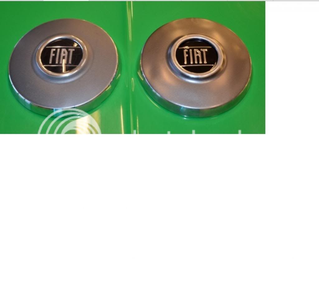

Here a photo.The new one on the left side. The other is repainted with a new emblem.

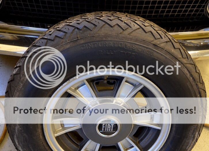

Here a photo on how the original hubcap is one the Cromodora wheels. Remember that the Cromodora wheels also had the black fields on the 2400 coupe.

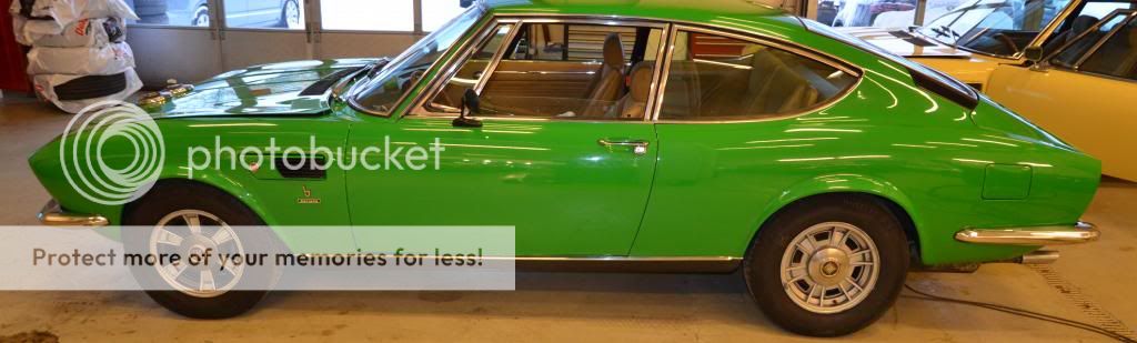

Here you can see the diffrence on the wheels. Factory original look on the front.What do owners prefer ?

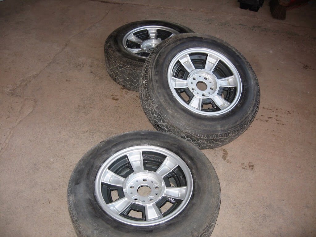

Actually, the 'black' on the wheels on my all original wheels is a very dark grey.
The dark part was still good, so I only repainted the silver part and then a clear gloss on them.

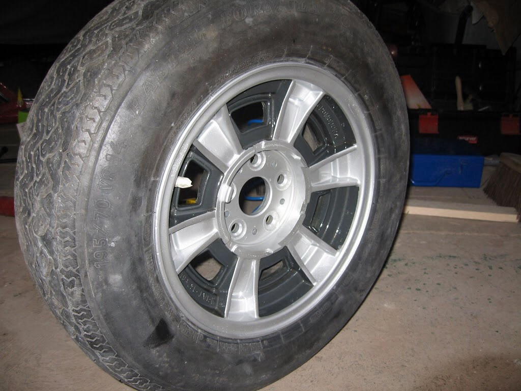

This is how they turned out.

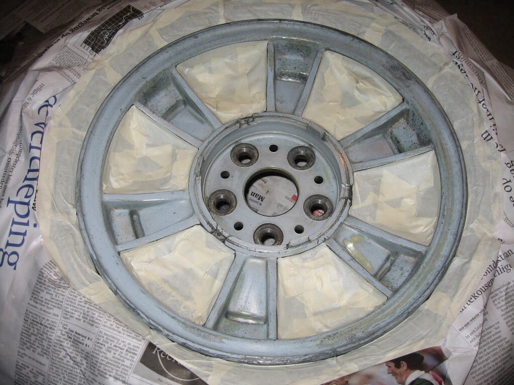

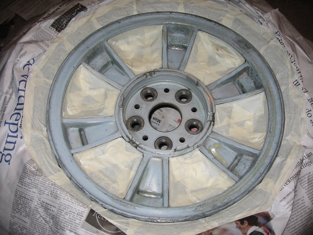

Sanded and taped off

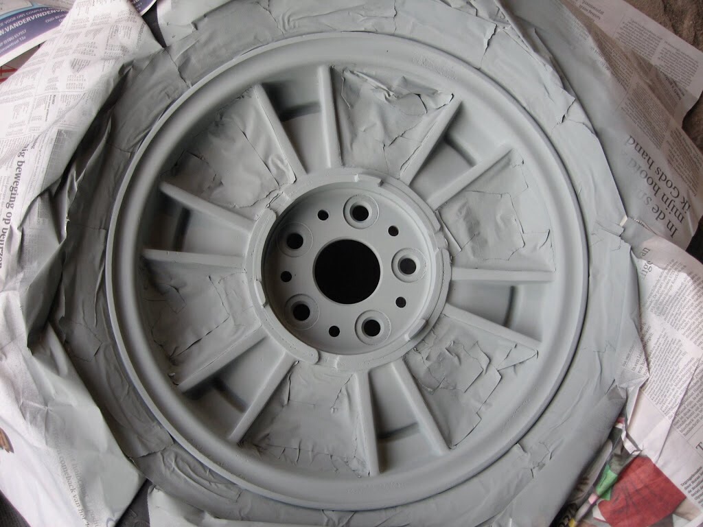

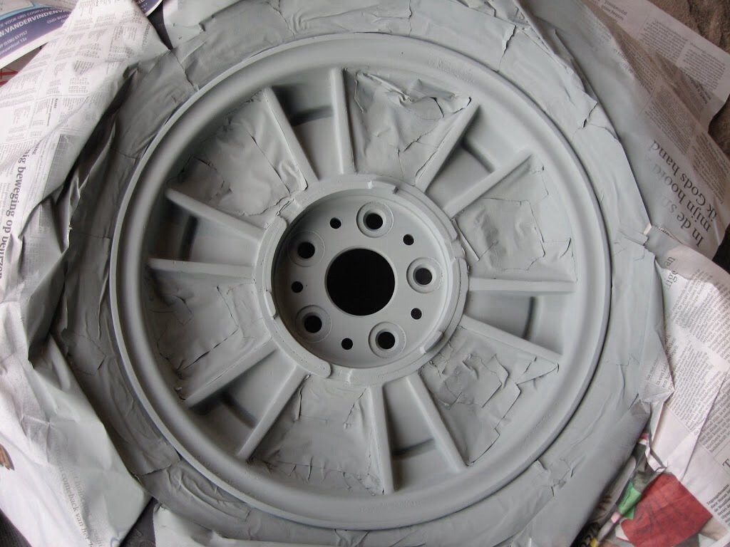

I first sanded the parts i wanted to paint, then put one layer of zinc spray on. For the silver part I just used a spray can. Just silver wheel spray that you get in every do it yourself store. I believe I just used cheap Motip. Any brand is fine...
Then I just covered it in a couple of layers of clear gloss from a spray can.
The dark grey part I did not paint. I taped it over with news paper when spraying the silver part.
I put gloss on the whole wheel to make it shine.
Zinc sprayed
Zinc sprayed

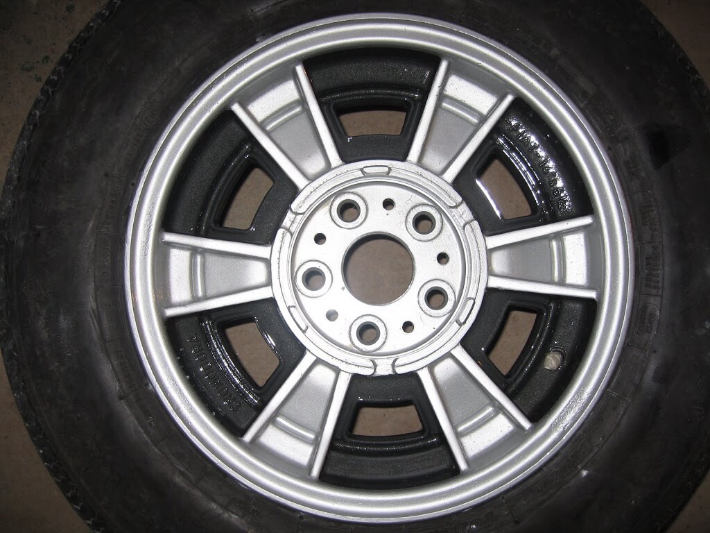

It is like Leo say,the dark fields on the Cromadora are not black.They are more dark gray original
Image[/url]
Also the dark fields on the Cromadora looks like a close match to gray color of the hubcaps
On the Cromodora dark fields I used black satin.It's more dark than the original but looking ok.
Image[/url]

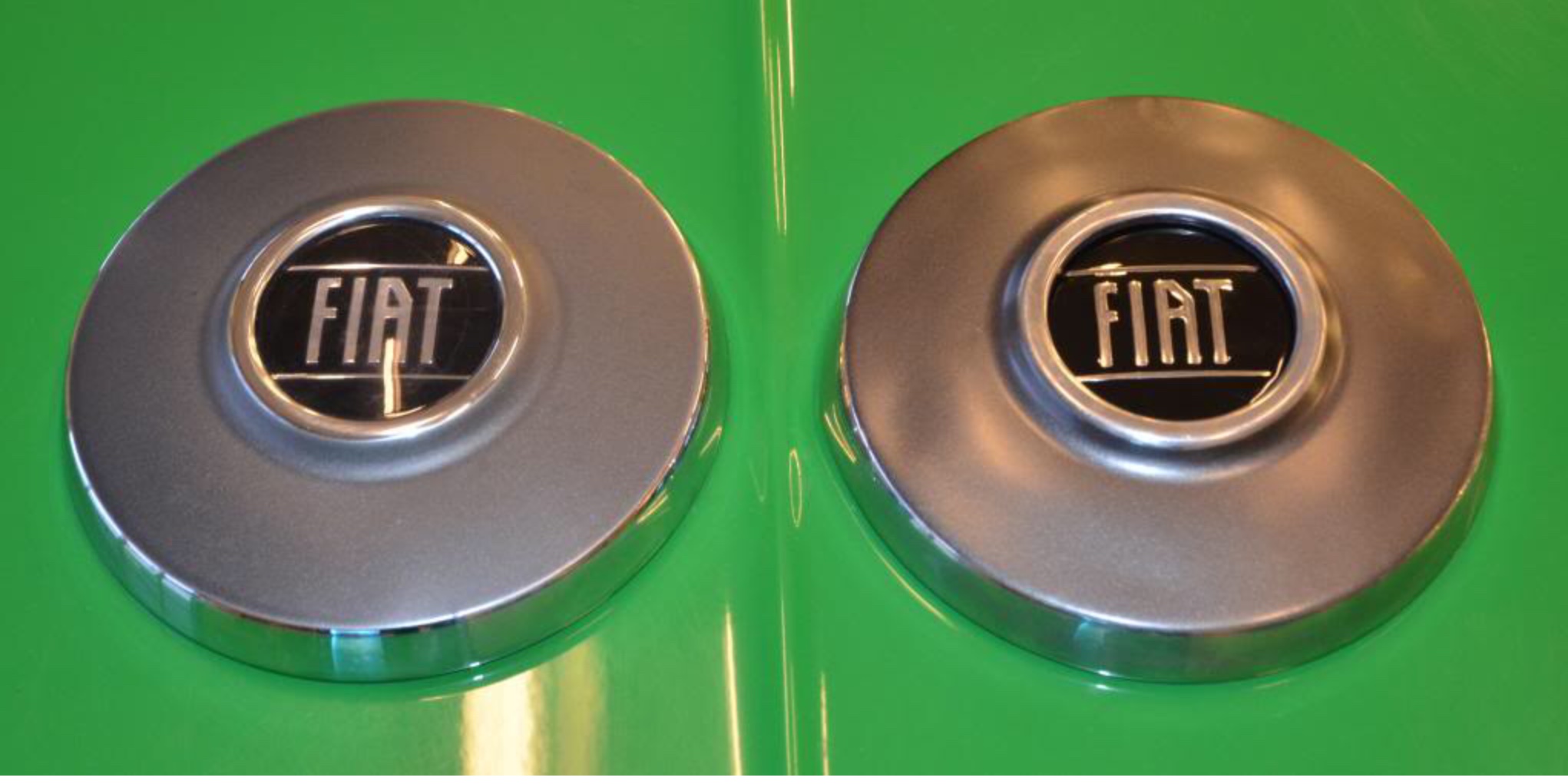

The color I used on the refurbished hubcaps; Alfa Romeo Giulietta color 319B.It's a metallic color but it works perfect on the hubcaps.Original brand new on the left and on the right the one refurbished in 319B.
