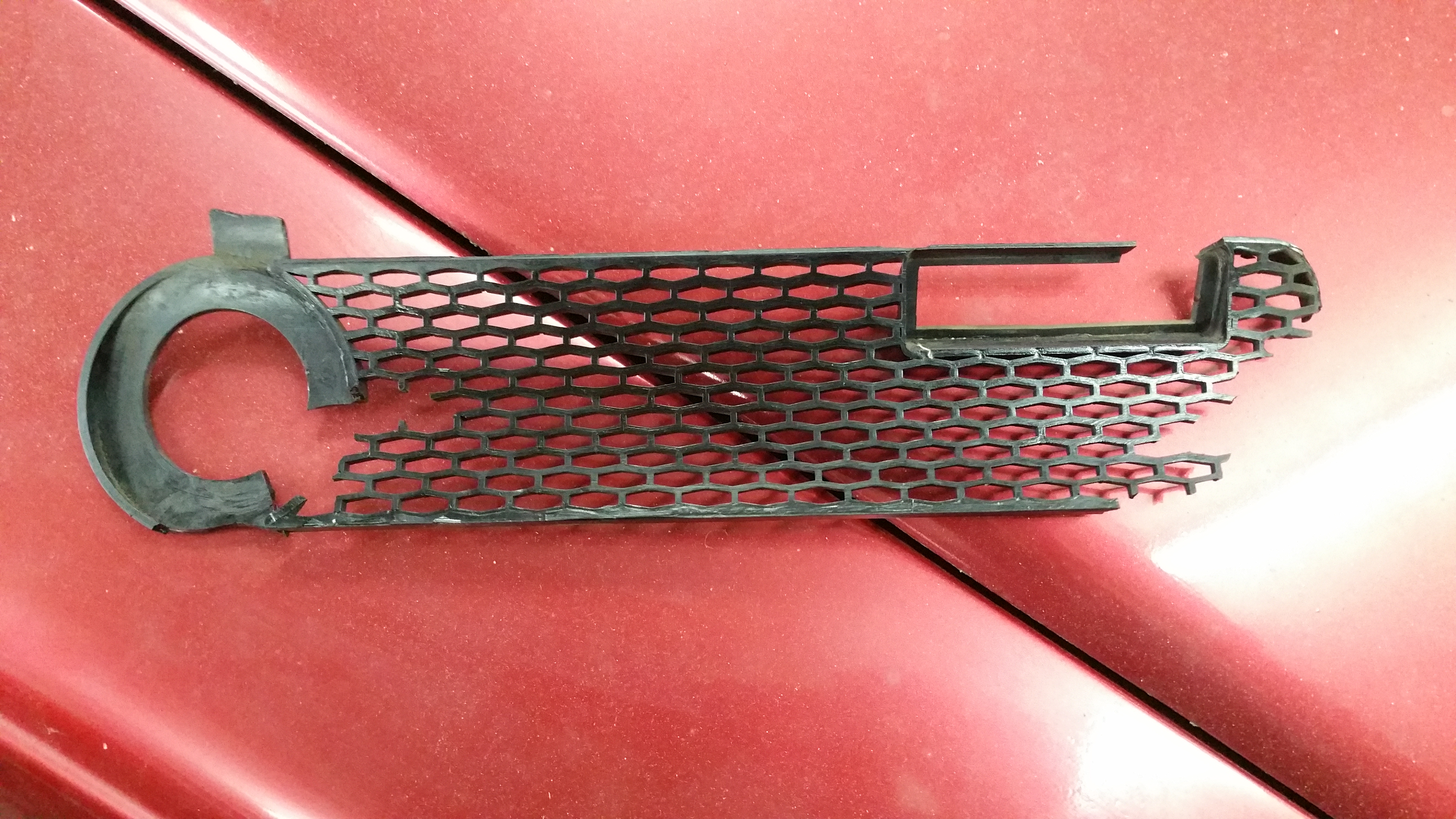

Today a set came in from a good manufacturer. I'm quite happy with the result. Looks pretty much identical to the original one.
Only thing is I have to coat it in a slightly more cream white color but other than that it looks and fits great.

You did a great job, bravo!
As for the color you can always paint them ...
I'm doing design rear passenger side grids.
I too would make them realize, as you did, in plastic or aluminum.
When I prepared something I will certainly post ....

Hope you will succeed your side grids as well, if you run into problems just let me know.
If you have difficulties you could also send it over to me and I could make some time to reproduce them as well. Most difficult thing in the process is to find out where to have them manufactured qualitywise, what 3d printing process should be used for what, what coating will be needed etc.etc. I think I have this sorted out by now.
This company that manufactured these grids will be able from next week on to print in color with this specific process, with this process it's normally quite difficult to have parts printed in a specific color.

I do not think to realize the side racks with a traditional 3D printing (hot wire).
I have already identified some companies that print 3D fusing powder material, even metal.
I'm waiting to have the file to request an estimate of the work.
I would still oriented, given the presence of the lamp housing that had already damaged the previous grid, to make it realize aluminum (money permitting).

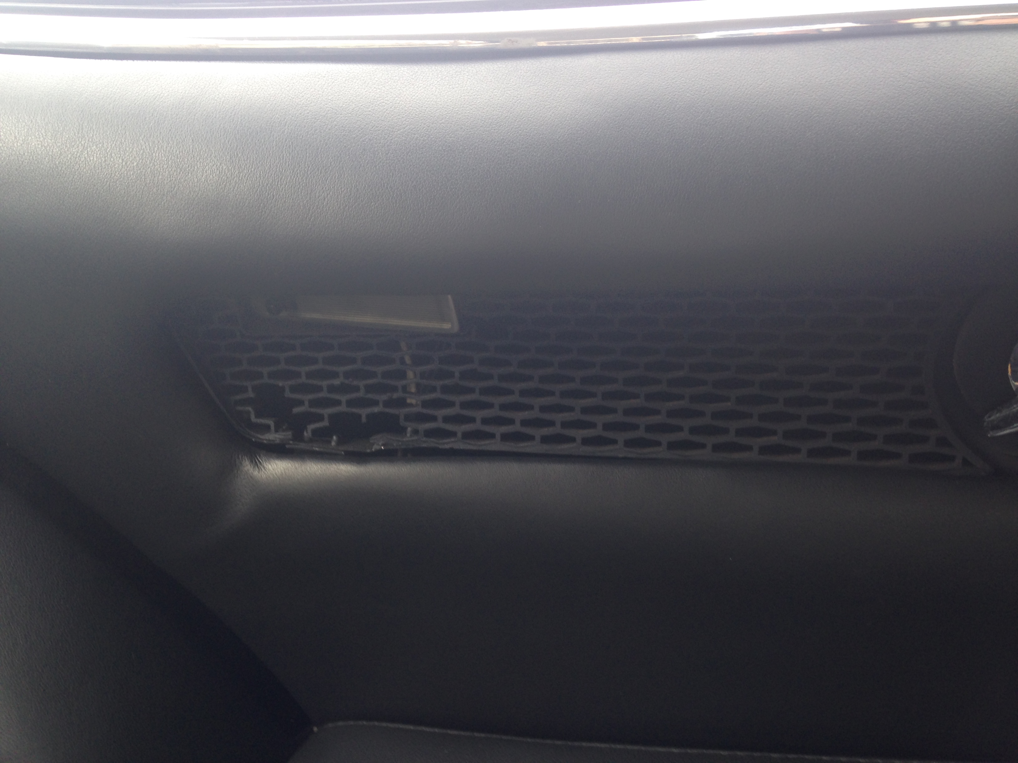

If you make rear passenger side grids (I assume you mean the ones with the lights at each side of the rear passenger compartment as per the image) I would be keen to buy some.
Rob

I made one complete set of air vent now, left and right, complete with knob, membrane and mechanism. Should function just like original.
